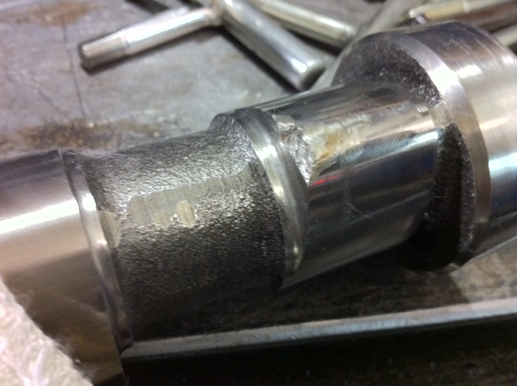

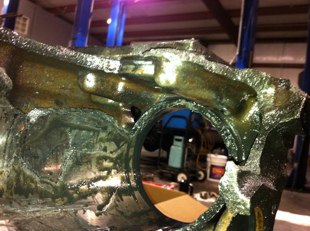

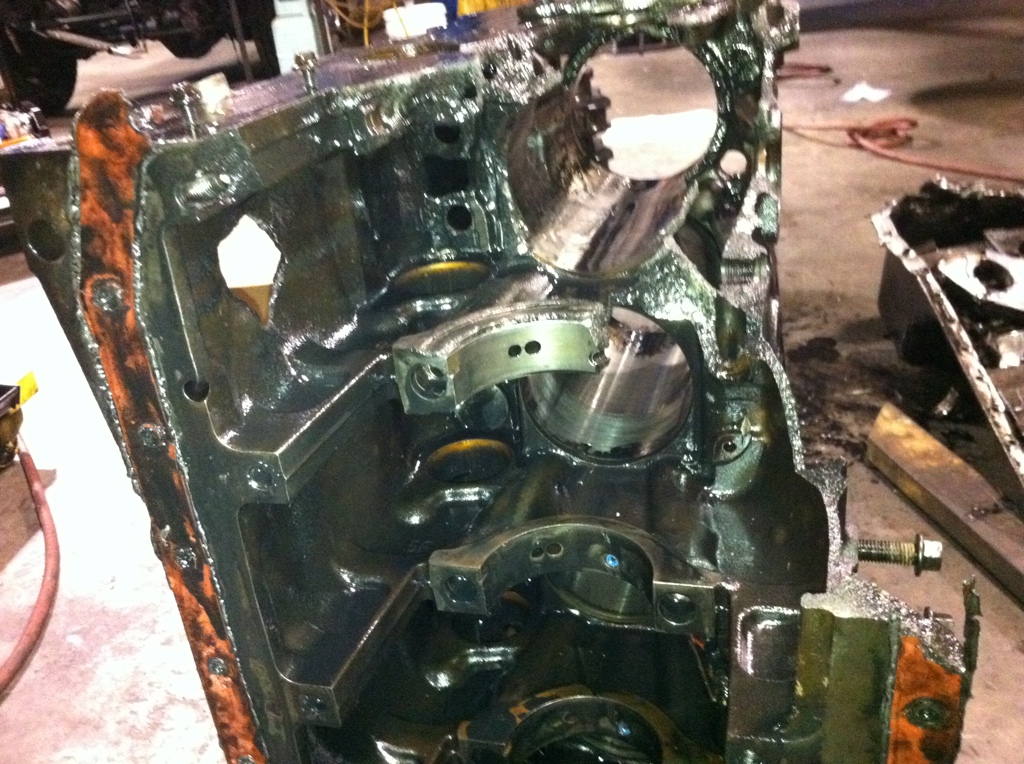

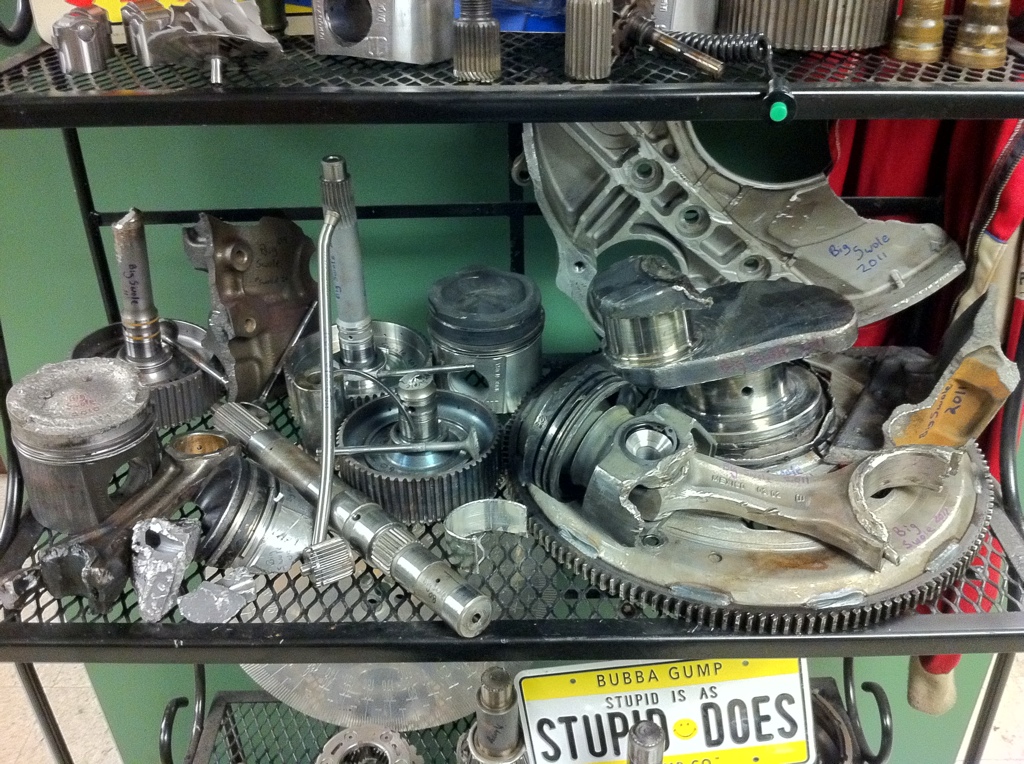

It even just nicked my Fletcher DP3 cam enough to where its not reusable! Ugh!

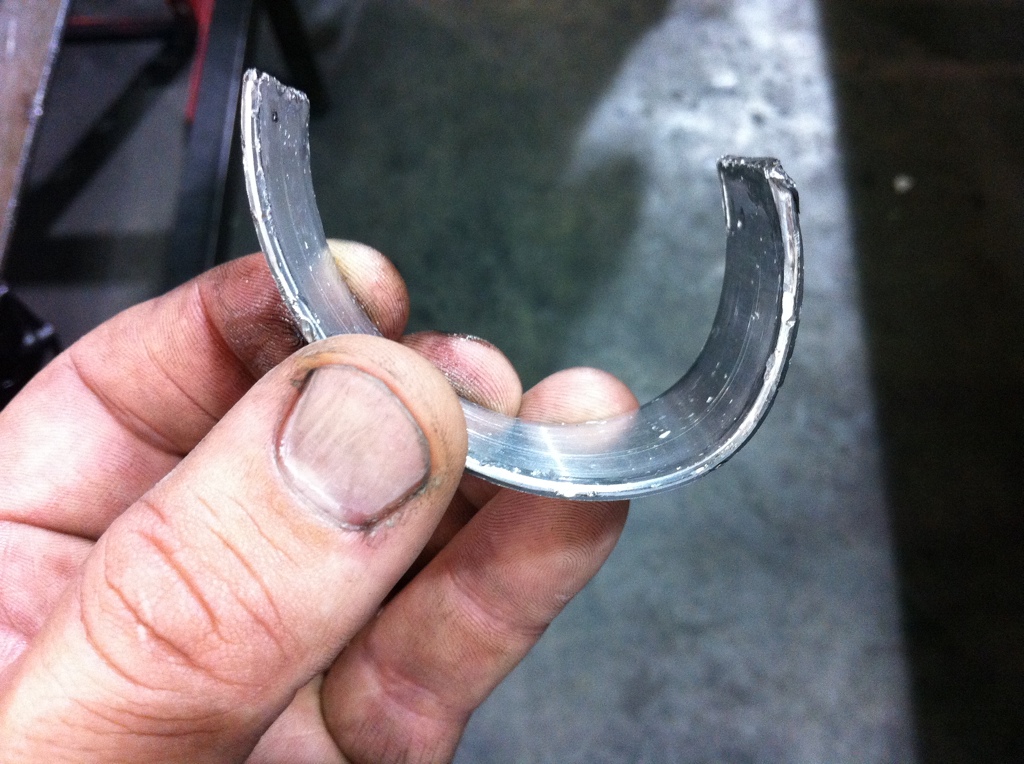

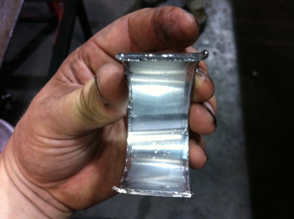

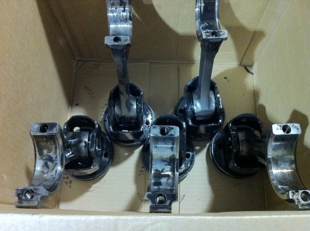

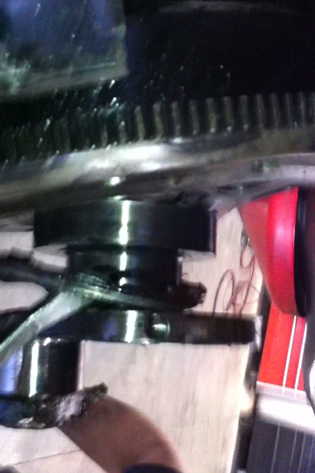

#6 rod bearing found inside

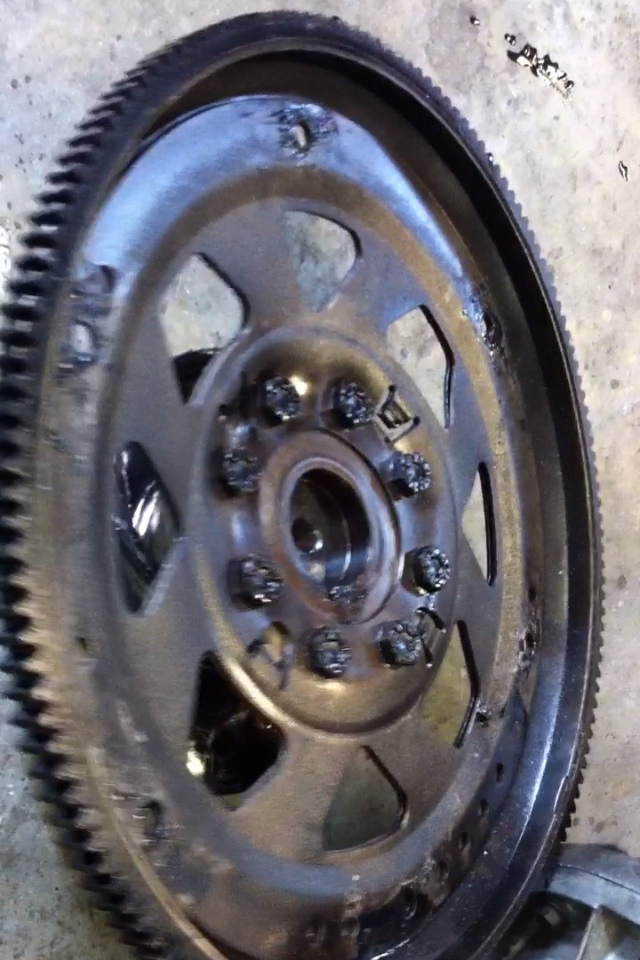

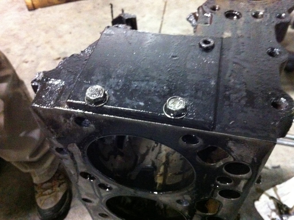

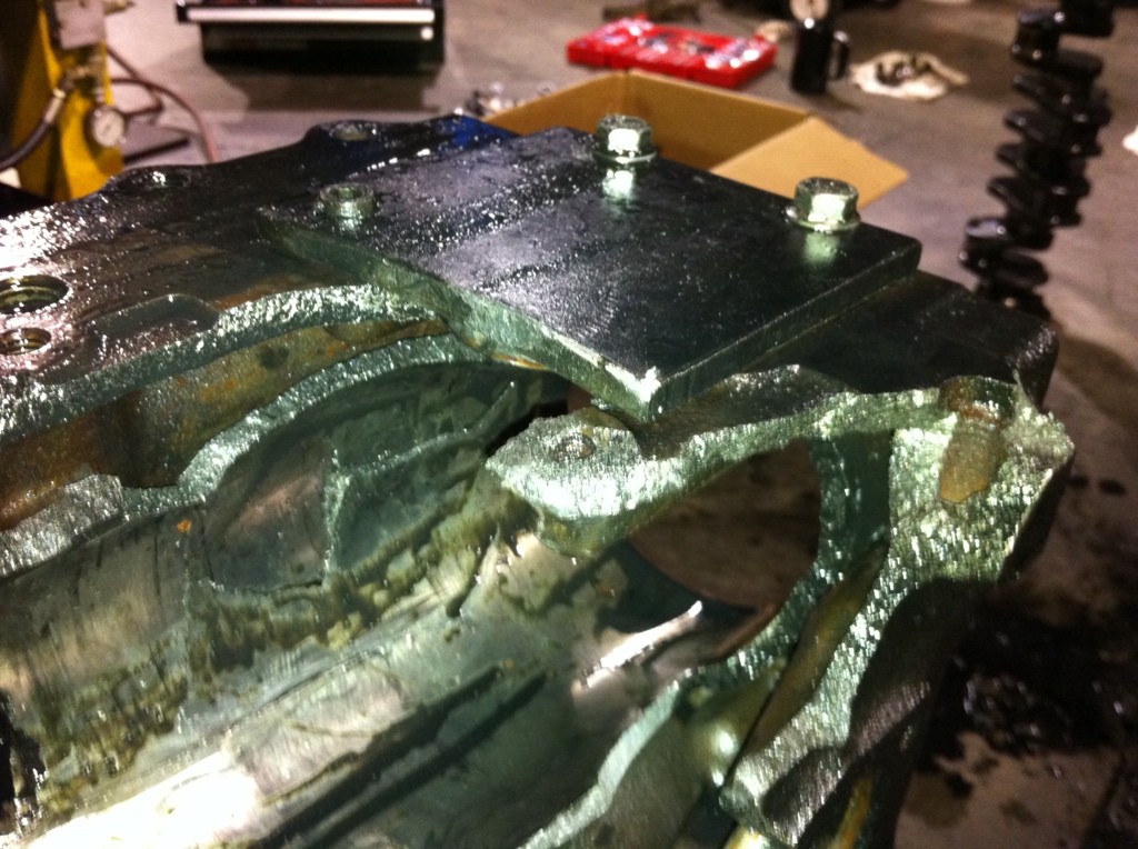

My NGM Diesel Custom rear freeze plug block off plate acts as a block stiffner too.... It actually saved my studs.

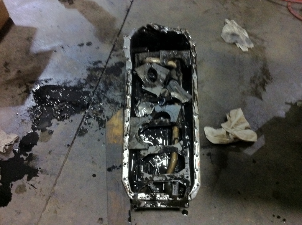

The Updated "Swoles Rack of Carnage"

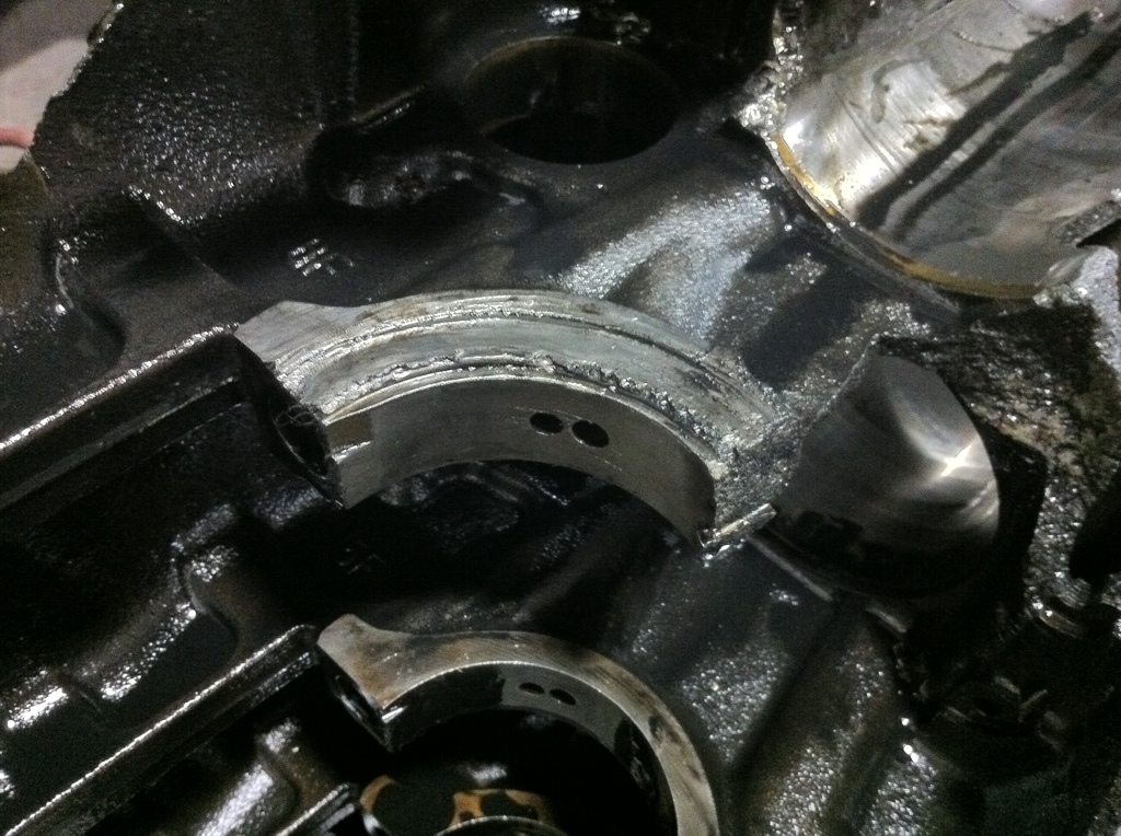

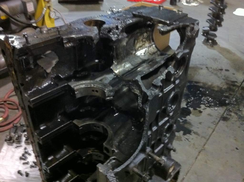

So whats the failure analysis results? What caused all this? What let go first?I had a similar failure in my shop a while back.

Keeping in mind that I've never torn anything down bigger than a single cylinder lawnmower engine, I'd like to know what initially caused that kind of damage too. I'm smart enough to see what happened, but I mean, did you lose a rod which then got hung up on other spinning parts and caused a major bind-up? Or did the crank break first? Or did something else come apart and cause the afore-mentioned failures?

As for the total and complete cause, we still really don't know.
There are so many opinions about it.
Jeff kinda thinks the actual cylinder let go first due to high cylinder pressures with my ssr settings... Sticking the piston and pulling the rod cap off.. Then when the crank came back round it caught and bent the rod and broke the crank...
But he also conceeds it could have been the crank first..
But then there are those that say the rod bolts may have been the culprit...
Since I had two seperate tranny breakages ( one turbine hub stripped and twisted input & then the other broken input a few weeks later) that allowed the motor to free rev until the rail pressure subsided.. They think with the extra weight of the monotherms that it could have weakined the crank and/or rod bolts...
Its really very hard to tell the exact cause...
Point is though, its a done deal... Damage is there no matter what the cause...
Sux either way....
