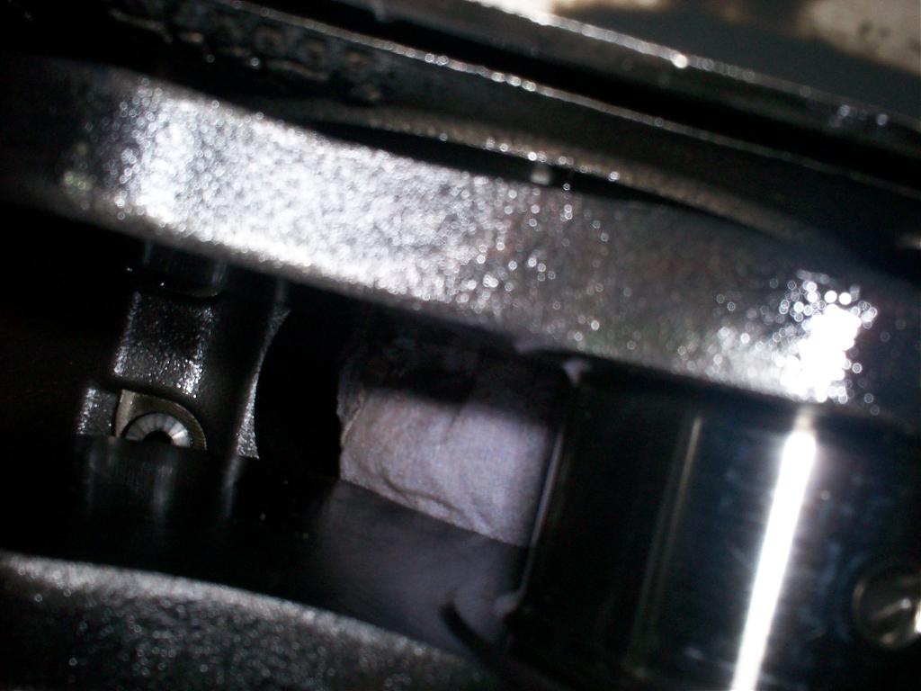

Hey 007,
I looked and I have lots of pics of broken stuff like pistons and trans parts but all I could find was this 1 pic that kinda shows the crank. Look good the surface of the crank looks pretty good. If you have scratches like the grooves on a record I would say it's time to head to the machine shop.
Topper

if it has a grove then it is time to turn it. i think you would be wasting your time if you sand it down and slap in a new bearing. as said earlier you would more than likely do more damage the second time around.good luck with it
