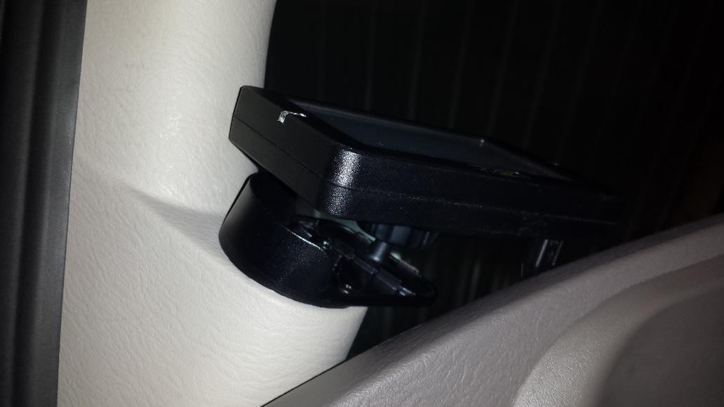

I used that pillar mount, but you cannot mount screen right to the "guage area". If you do (I did make a mount for that initially)
when you rotate screen so it is kind of level, upper left corner hits pillar mount. It also is not out far enough to clear top edge of dash.
Ended up taking chance on this kit, which is really for Edge stuff.....
https://www.amazon.com/gp/product/B00AN5MZ2I/ref=ppx_yo_dt_b_asin_title_o00_s00?ie=UTF8&psc=1 https://www.amazon.com/gp/product/B00AN5MZ2I/ref=ppx_yo_dt_b_asin_title_o00_s00?ie=UTF8&psc=1
it moves screen back and towards pass side. Fits nice and mounts right up perfect.
One note, the part that mounts inside guage hole has 4 ears, 2 of them have to be ground down to clear lower edge of
guage mount hole, inside A-pillar
But I think it is going to be a bit wobbly, so I might cut a piece of pipe insulation and put it
between round edge of mount, right in front of "guage" hole, and TOUCH screen.
