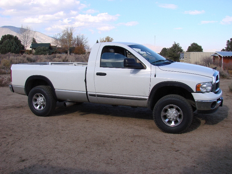

Here's my setup.
I moved the muffler 37 inches forward and cut up the tail pipe to make a nice angled setup out the side. It gives a lot more room under the truck and changes the sound to a slightly more raspy and mechanical sound, but not louder. I used a tapped hole in the frame to make an additional mount and routed the pipe out where the frame turns up a bit. Now I have room under there for an air tank. Worked out great and I love it.
I do get some soot on the tire after a few thousand miles, similar to the brake dust on the front wheels, but the rear of the truck stays clean and nothing shows up on the rear fender. Also it has no affect on the tire temperature.
This is an old pic before the Dynatrac kit.
