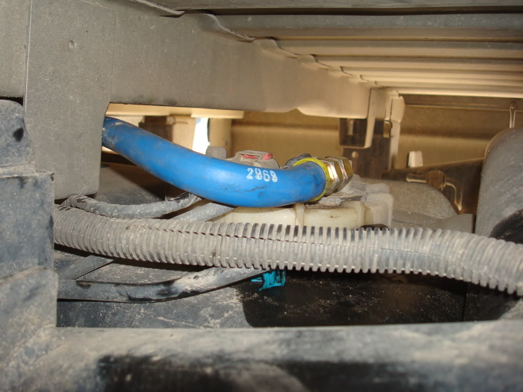

No, you do not need to drill with the raptor...
Hold on, getting you pictures. I've done this a few times...
The instruction manual was pretty clear... what's the problem? Are you sure you have the raptor? (pictured above)

what is that fitting on the fuel tank?
Also we removed the old lift pump on the fuel filter canister and found no threads to put that fitting in the filter canister. i looked at my early 04 dodge and i have a threaded plate back there, what are we supposed to do there?

The Raptor kit is supposed to come with an adapter if you ordered the right kit. The original fuel pump was mounted on with two screws. The adapter has a nipple with an o-ring on it, and the two screws mount on the sides.
You may have ordered a kit for a truck that has an in tank pump.
