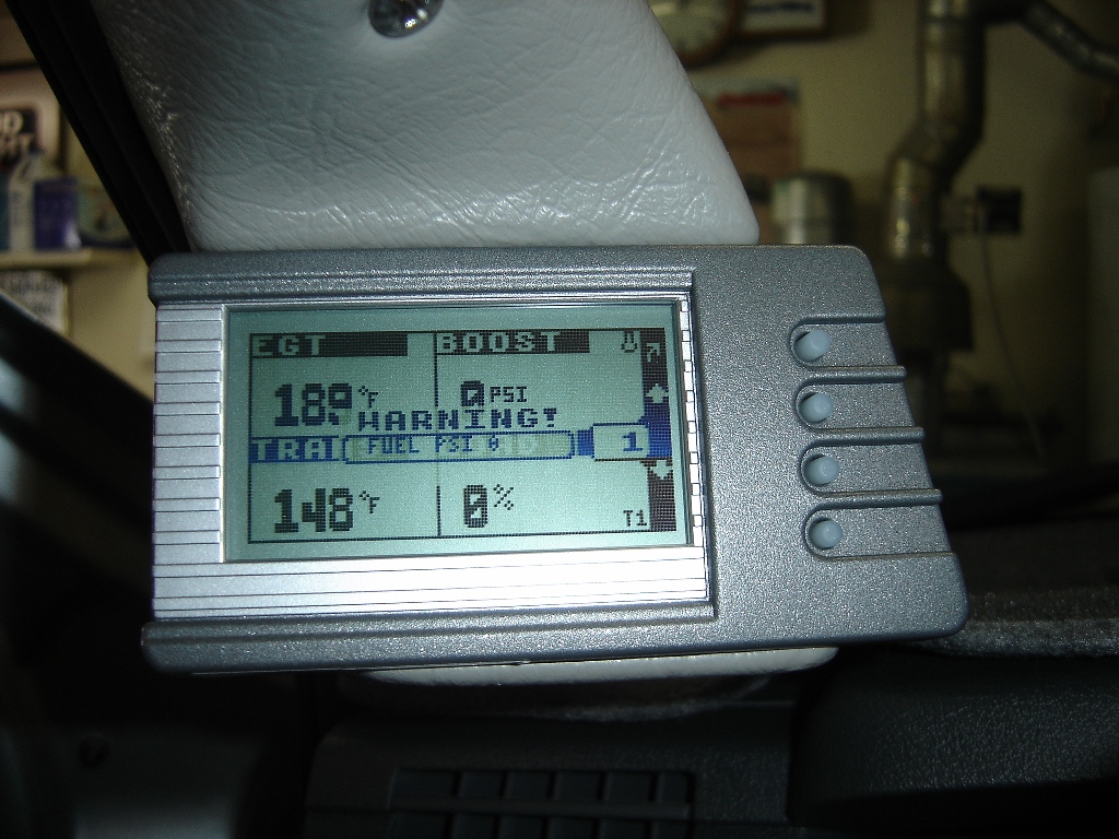

I have been wanting/needing gauges for a while now since my rig is used primarily for towing the Jeep on road trips and such. I had done quite a bit of research and after pricing seperate gauges, seperate power adders and such, the cost was pretty astronomical and had really held me back in purchasing them.
After researching the Quad, I decided to treat myself for Christmas, and got it installed this weekend. Just idling the truck and setting up the perameters I got all giddy. You all know what I'm talking about!
After a road test, I can say I am more than thrilled with the features and quality of this unit.
I ran out of road or into traffic before I could even work the truck hard. It was that quick and responsive! By far this unit is the most easy, user friendly, easy to understand, and easy to install system I have used.

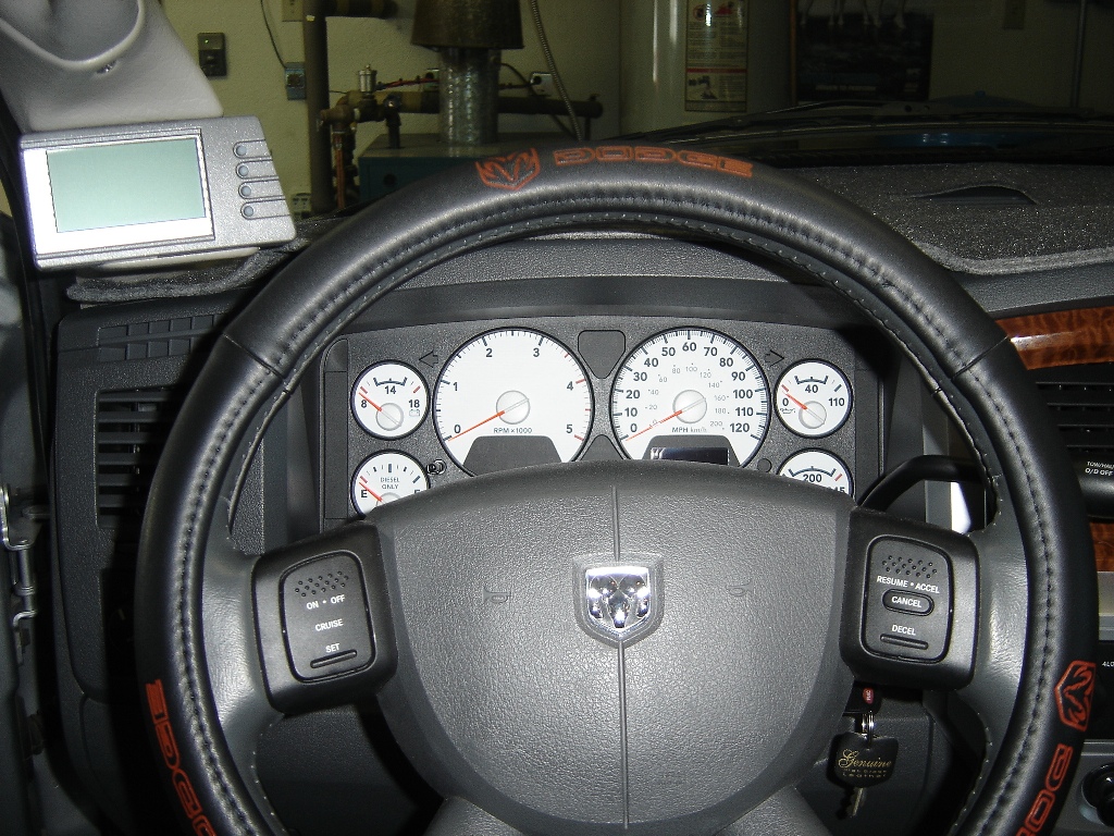

I did at first think that the Pulse monitor was a little plain and kinda cheap looking, (the advertising pictures do it no justice) but after actually mounting it in the Quad pillar mount, and actually playing with the buttons, I am very pleased. The simple and very easy to read display actually exceeded my expectations. The buttons are very responsive as in you don't have to bury your finger in them to make a change.
The defuel and warning settings are A++ and work very well. You even get a turbo timer included! My specific unit has 14 tunes built in, the ability to modify the tunes, and you can even download custom tunes.
The only thing I did different in the installation was mount the computer in the cab instead of under the hood. I like things to be low key. While I was there, I also installed an accessory fuse block that is powerd by a relay and a set of circuit breakers under the hood I installed.
I was previously running a Superchips Flashpaq alone, and currently have it stacked with the Quad with no contradiction thus so far. I have the SC on the tow tune currently, and will leave it there for now. The SC has the ability to enable the high idle feature which is primarily why I left it on. The Quad does not offer that option. You can however adjust the tire size with the Quad. The Quad also has the ability to read and erase trouble codes too.
I really wanted to make another thread on this system, due to when I researched the Quad here originally, some of the searches were kinda thin. There really was no detailed info (that I found anyway). So if some one searches the Quad in th future, maybe this post will help answer some questions and maybe spark some more ideas.
The Quad by far hands down appears to be the best bang for the buck in features, power, gauges and user safety settings. After also talking to their customer service, they seem to have the most knowledgable personel I have experienced in quite a while on product specifics. Heck their instruction manuals are even like mini owners manuals but in full color.
I attached some pics here. The third one is of the accessory fuse block I installed and the last pic is what you do when it is below zero outside. My garage is heated with waste heat after it circulates through the house, but it was still pretty cold and I had to warm my tools up somehow! LOL
