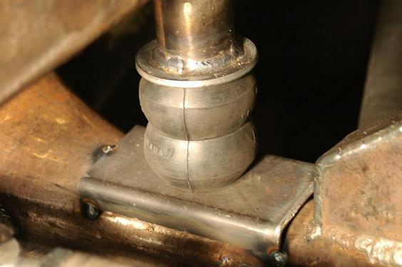

Sorry but I gotta do this to you......
Mark
Man . . . you guys are demanding . Here is a pic of the one of the front Timberins. They are supposed to rest on the axle.
Here is a pic of one of the Timbren's on the rear. It is supposed to be 1/2" - 1" above the axle.
Old Feb 3, 2007 | 07:40 PM
FirstDodge's Avatar
Posts: 291
From: Cary, NC
Originally Posted by 35" 05'
does yours bottom out when the tires are going up or down? Mine does it bad going down.
Down. It would bottom out REALLY easy going over speed bumps or dips in the road. Really poor for a 3500 suspension.
Nice thanks for the pic's!!
whats the timbren part number for those???
I can buy them locally my Jeep ones where 30 bucks a piece, but I need to know your part number please.
Mark

This is for the '06 Mega 4WD:
Front - DF25004B
Rear - DR3500CA
Here is a link to Timbren's web site with the part numbers for Dodge:
http://www.timbren.com/timbren-appli...dodge-jeep.htm
