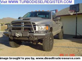

How about 37x13.50x17 Toyo MT's on factory alloy powdercoated wheels? KORE RACE suspension. About 2.5 inch up front. 10 inches of travel with limit straps.

hey fred, what kind of clearance problems did you have with only 2.5inches of lift. ANd what gears and MPG are you gettin

The tires don't touch the fenders at all. They do rub the radius arms slightly, but KORE is working on some replacement ones that should clear. Also, I have some fiberglass fender replacements I just picked up today from the paint shop going on the front as soon as I can get them on.
Here's what they look like.
Mileage didn't drop too much. I ran the 37 GY MTRs(out), for 16K before these. For where I am for power, the mileage is not bad IMO.
