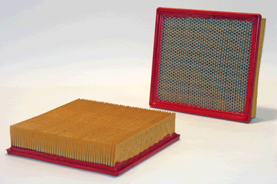

I have been running Napa Gold/Wix 2846 air filters for 100,000+ miles. The 2846 is rated at 675cfm. My filter minder has never moved, even after 20,000 miles. I usually replace the filter every 15,000 miles.

Originally Posted by surfram
I have been running Napa Gold/Wix 2846 air filters for 100,000+ miles. The 2846 is rated at 675cfm. My filter minder has never moved...
Same here, but only 20k miles so far. I may try the new Mopar filter next time, just to compare, but it's hard to beat the Wix at 675CFM. You'd have to be making 600hp to even come close to stressing it.
I really like the Napa Gold filter, much better then the Amsoil EAA189 filter I had on my truck. I took it off last month when I discovered dust was getting by it. The EAA189 also pulled the filter minder down in the red within a few days. I will never use the EAA189 again. I will probably get one of the new 53034249AA filters next.
