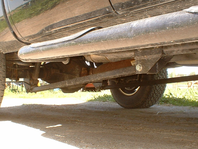

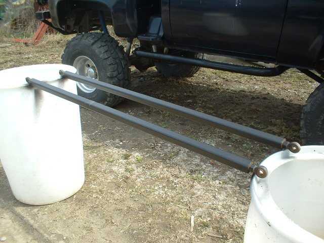

bobby1stack's Avatar
Posts: 75
From: Indiana
I used 1 1/2" X 1/4" square tube. Need to make sure go past the bed.
Attached Thumbnails Making my own tracton bars?-robert-002.jpg   Making my own tracton bars?-robert-015.jpg
Old Aug 15, 2008 | 03:45 PM
dieselfreak21's Avatar
Posts: 698
From: Nixa, Missouri
bobby1stack
I am assuming your brackets on the back are wellded to the bottom of the shock mount. If not please confirm attachment if you do not ming sharing. if not i understand. Also if you don't mind sharing how are the front brackets mounted. The manual on my 03 says no drilling or welding but that is also from DC and i only bought the truck b/c of the cummins.
