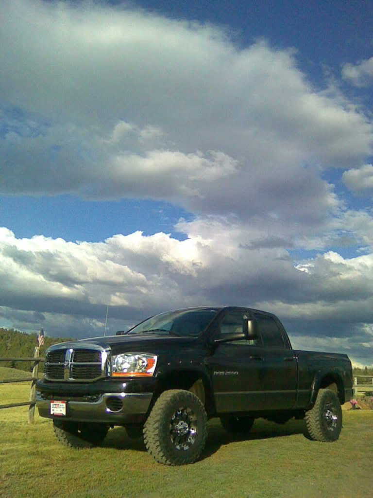

Hey DTR guys, have an 06 2500 auto with a few mods- AFE stage 2 intake, CAT delete with high flow muffler, and a Diablo Power Puck(not very popular, I know, but it works for now.)
Some pics-- Sorry for cell phone quality :/
The truck

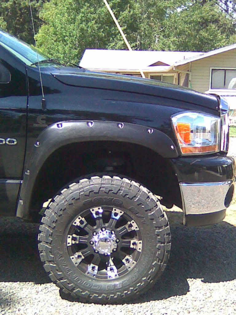

The Meats
