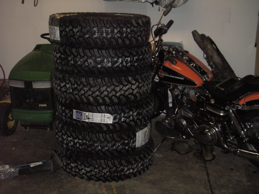

255/85 Works perfect. They are a 33x10 Here are the ones I just got for my 98

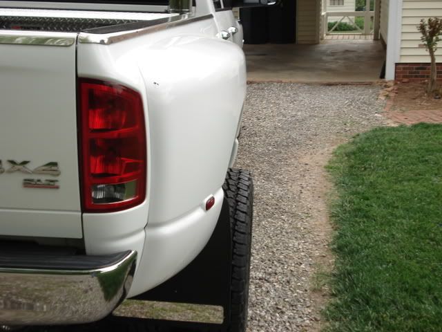

First pic is 285/70/17's with a 1 1/2" spacer(gives a good idea of how much flare is needed).Second pic is 265/70/17's with a 1/4" spacer. djbikeman is correct in his earlier post.The 285's with no spacer are way to close for comfort.
How close were your 285's with no space? And do you think you could run them with a 1/4" spacer?

They don't touch with the 1/4" spacer but are very close.I wouldn't want to tow heavy with that set up.I couldn't get my pinkie finger in between them.For daily driving you could get by.
