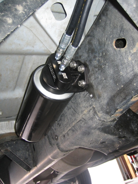

Here is what it would look like.
Ya know, a more intelligent person would use a center punch and poke a hole in it to drain off the oil before changing it. Give me a call when you get a chance, I have a proposition for you.
NO you pervert ....... something else.

That looks like my truck

the orfice only takes 5 minutes max to make and the pix above is the way to go
My dad has his bypass in the same spot as mine, pictured above, and he says it doesn't spill as long as the truck sits overnight.... I will probably try it once, and if that doesn't work go with the punch hole method... I would love to not have to take my skid off every time.
