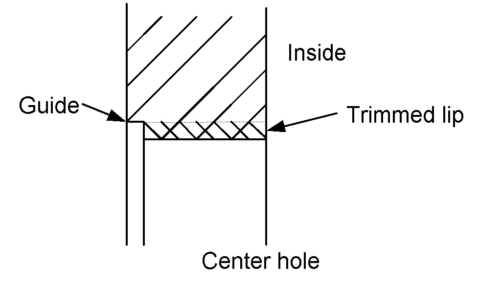

Hummer H2 Wheels:
Size: 17" x 8.5"
Bolt Pattern: 8x6.5
Off-set: 18 MM
Backspacing: 5.5"
Weight Rating: 3,195 lbs per rim
Hub Size: ???
Stock Wheels:
Bolt Pattern: 8x6.5
Size: 17" x 8"
Offset: ??
Backspacing: 6.25"
Weight Rating: ???
Hub Size: 4.767"
Can anyone "fill-in the blanks" for the stock whee info?....or verify if the above info is correct?

Here's everything you need to know. I've machined 2 sets for fellow chapter members. Hardest part is cutting the center caps. Dremel works great.
http://towrig.com/hummerh2wheelupgrade.shtml

I used a router with a 1" flush trim bit.Worked good about 3-4 min. per wheel.

How do you maintain the tolerance of the circle as you go around the hole routing out the extra?
Do you have some sort of home made jig or something? I just can picture how you move the router around the circle and keep the hole even all the way around or not skip out.

I too would be interested to find out how you guys are using a router to mill out the hub area!
I just worry about balancing and safety issues if the wheels are not machined correctly and accurately.
I think I am going to start calling around local machine shops.......

I think the center of the wheel has a step on it that the ball bearing on the flush trimming bit rides on, thus trimming off the lip. Just a guess judging from the pictures I've seen. The wheels are lugcentric, meaning it's the lugs that center it on the hub not the center bore.
I think I'm going to pick up a set of chrome ones if the price is right, found some for sale localy and going to call tomorrow. Thinking about machining the center bore a bit larger and routing a chamfer on the back to accept a push through style center cap (I have a brand new set of chrome ones never used) and getting some Mcgard lug nuts too, anyone ever tried this before?
That is correct

This subject comes up over and over again, here's something I posted back in Dec 06:
"I don't have pictures handy, drawing attached. The H2s have a lip that is trimmed off similar to trimming off excess formica from a countertop. The wheel lip is much thicker, however.
The router with a $14 trim bit is not going to give you as smooth a finish as a machined wheel, but certainly does not look like a hack job. The original front edge is retained as well as 1/8 inch or so of the hole, so when the wheel is mounted on the truck you wouldn't notice the hole expansion, you just see the factory smooth finish."
If you understand how you trim the formica countertop edge with a router without gouging the countertop, you understand how this method gives you a perfect circle, although not mirror finish.
I should note that the center done this way still retains some of the cone for those worrying about center wheel balance machines, and they are actually a slightly smaller hole than stock wheels, so whether dodge is lug or hub centric is irrelevant to the discussion..... the only problem with the otherwise decent article that gets reference everywhere is that it fails to mention the safest and best way to open up the center hole.
https://www.dieseltruckresource.com/...3&d=1174044383
"I bought a 1/2 in frued carbide bearing flush trim bit for $14, set up the router such that the bearing was catching a bit of the wheel, flipped the wheel/tire over, good side down, and slowly trimmed around the hole clockwise. Five minutes later all four wheels were done. This is no sweat for anyone that's used a router, and I now have a nice stack of aluminum tinsel for holiday decorating. The router bit showed no sign of wear. The hole is just a knat's eyelash smaller than the OEM wheels and has a smooth enough finish. "
