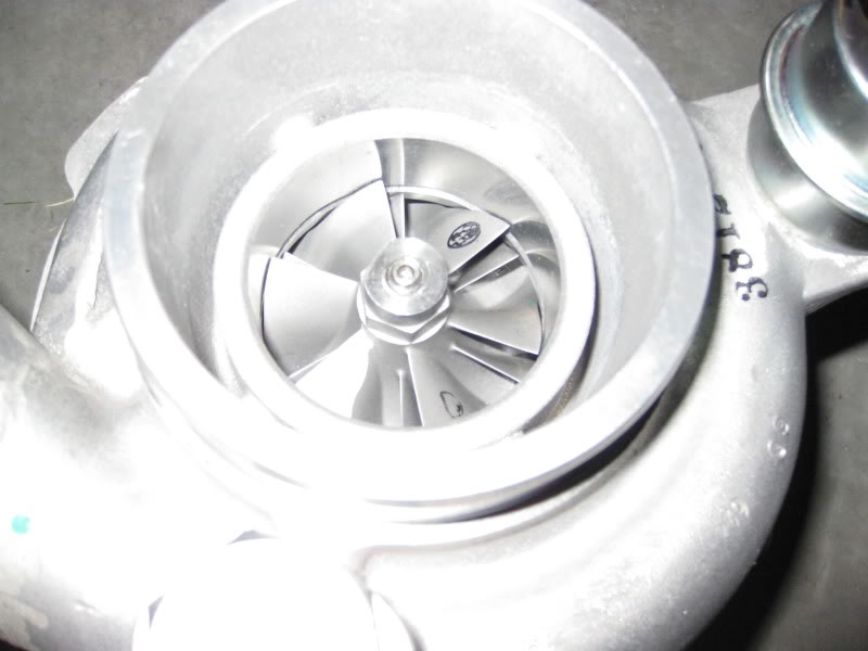

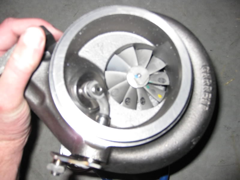

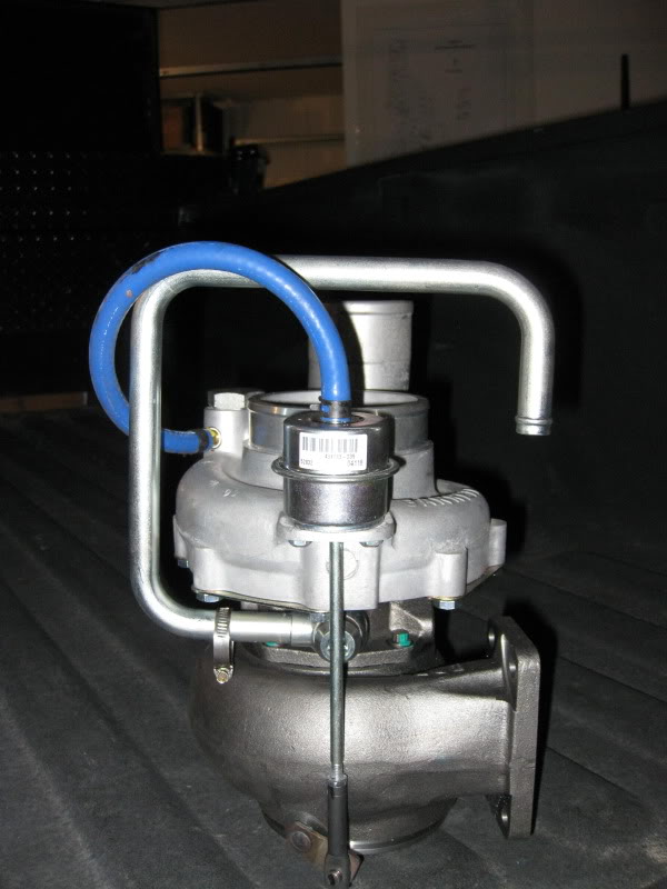

I recently installed a Garrett Powermax Stage 2 turbo, which is a GT3782R. It’s a 62/64/.89 turbo. The comp wheel is a 61.4x82mm 6 blade wheel, and is normally found in the GT3582R turbo. The turbine wheel is a 72.5x64mm 10 blade wheel, and is normally found in a GT3788R. The center section is a GT37R water cooled ball-bearing unit. The exhaust housing is a .89 a/r divided and internally gated unit that has the HE351 4.4” outlet on it. This combo is designed specifically for the 3rd gen Cummins.
The kit is a well designed and was quite easy to install. I spent about 5 hours doing the install which included a new (to-me) exhaust manifold. The only issue I had was with one of the bolts required for bolting the turbo to the manifold. It was too long and hit the turbine housing. I had to get another at the parts store. The rest of the kit fit perfectly, the intake, exhaust, coolant, and oil lines all attached easily and no adjustment was required.
Prior to putting the turbo on the manifold you need to attach the inlet coolant line. I had to disconnect the WG rod to get the allen wrench into the banjo bolt.

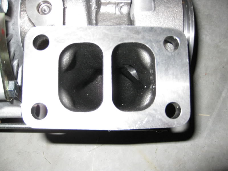

Turbo ready for install
Manifold ready for the turbo.

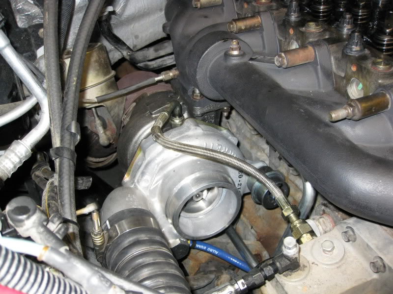

Bolted in place.

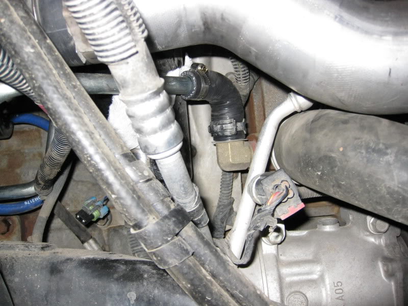

Where the inlet for the coolant connects to the OEM heater core return.

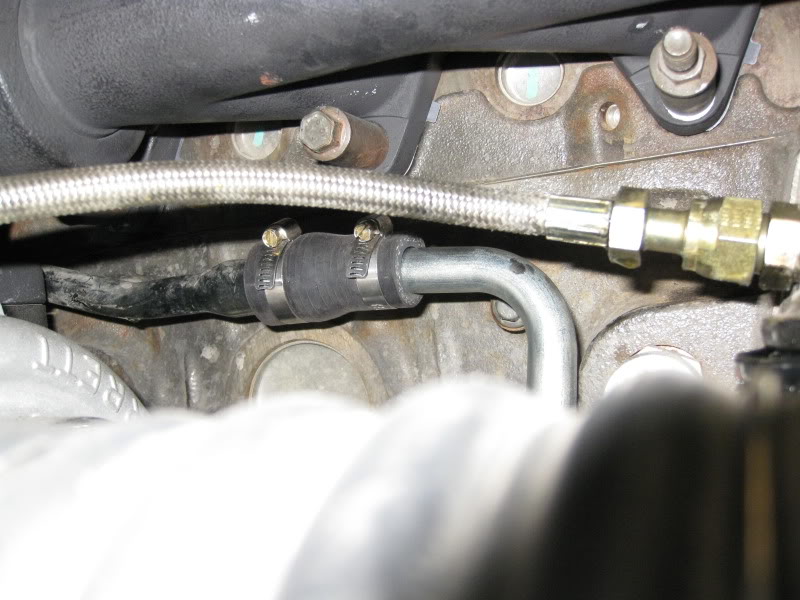

Where the coolant return goes into the water pump.

Completed install, wrapped in Turbo Performance blankets.
