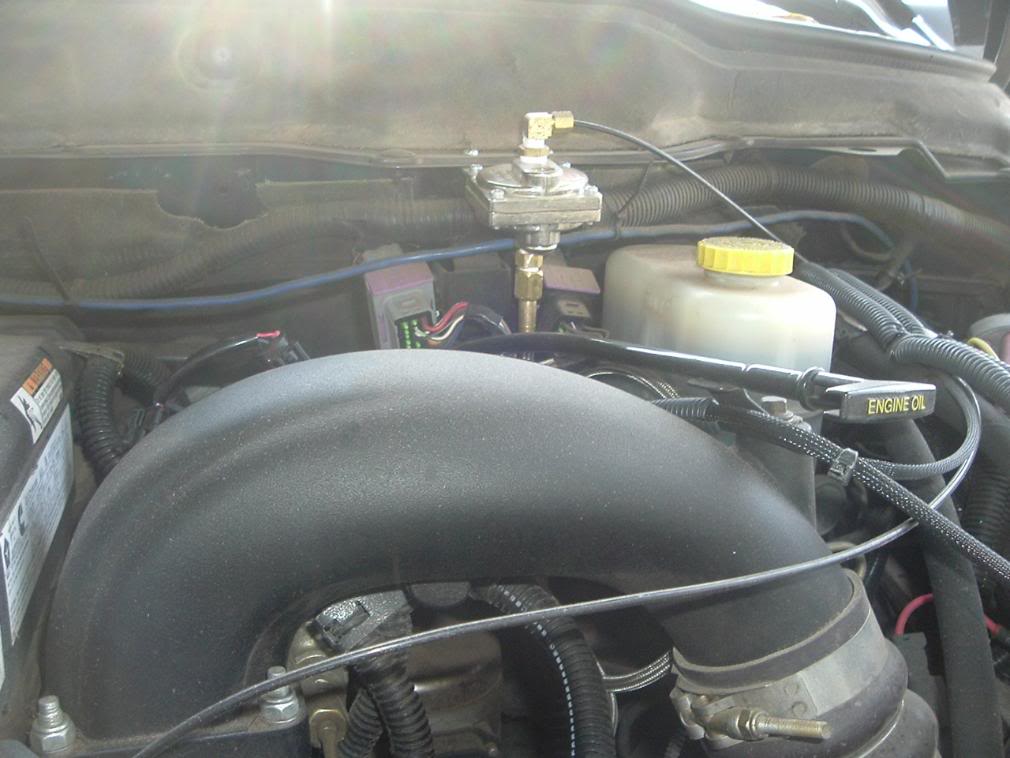

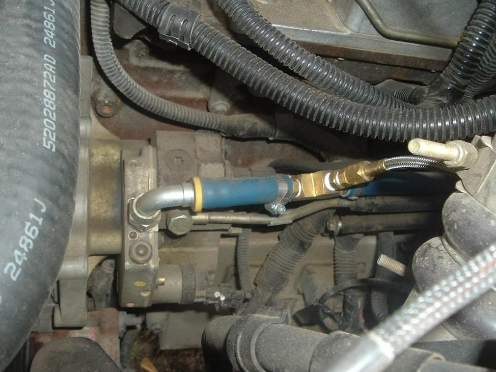

Made my own fitting to tie into the line, auto parts store will have what you need, got my stuff from Napa. Tied in directly behind the cp3 so I could get an accurate reading at the injector pump.

I have a 90* fitting that is on the CP3 that is tapped.
I am not a fan of the isolators... I've been running diesel to my gauge for 4 years now, never had a problem. That's just my two cents...
