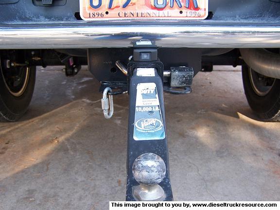

Old Jun 26, 2007 | 11:00 AM
jrussell's Avatar
Posts: 3,660
From: Florida
Here's one of the holes I was talking about (this was taken before I put the valve stems there)...
There's one on each side and they are just about the right size. The locking pin I use comes kinda close, but I can still get in there with a gauge and hose to adjust them.
