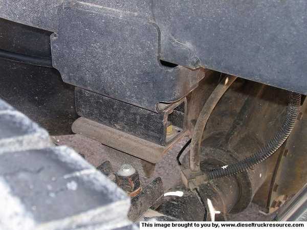

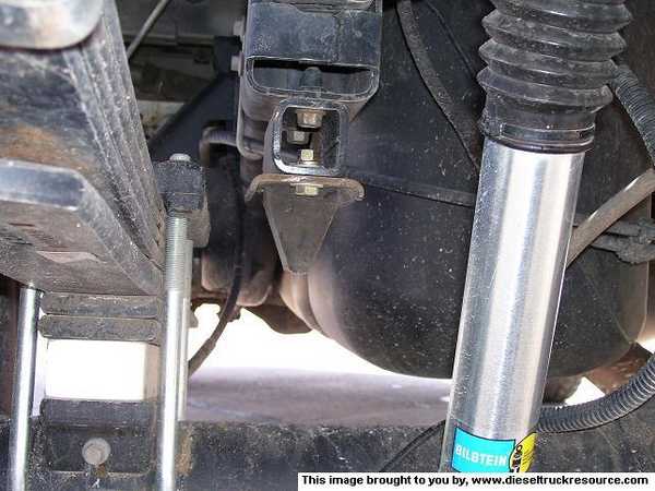

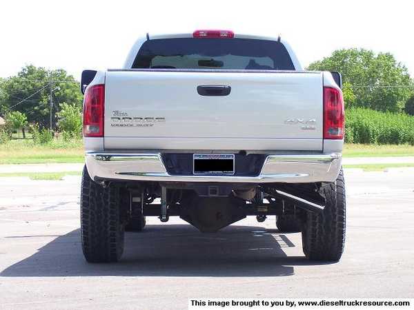

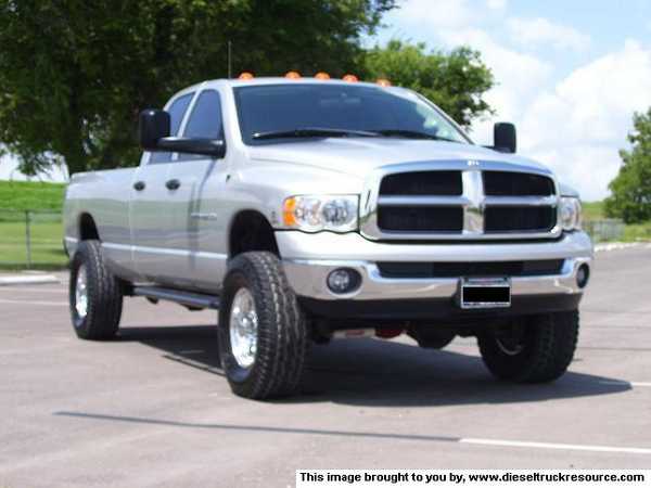

i think i just about got it how i want it... well for now at least! let me hear what you think. 3" spacers in front. 1.5 blocks in rear. bilstein 5100 shocks.

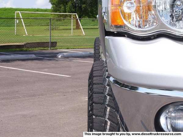

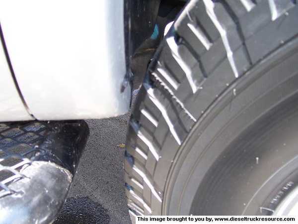

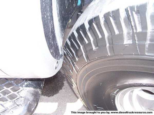

the wheels are 17x8 american eagle 058's with 4.5 back spacing. tires are 325 70 17 (35x13.5) toyo open country all terrain. they stick out about 2" but thats what i was kind of going for, it started looking to tall and skinny.
they clear the fender but rub the plactic inner wheel well at full lock

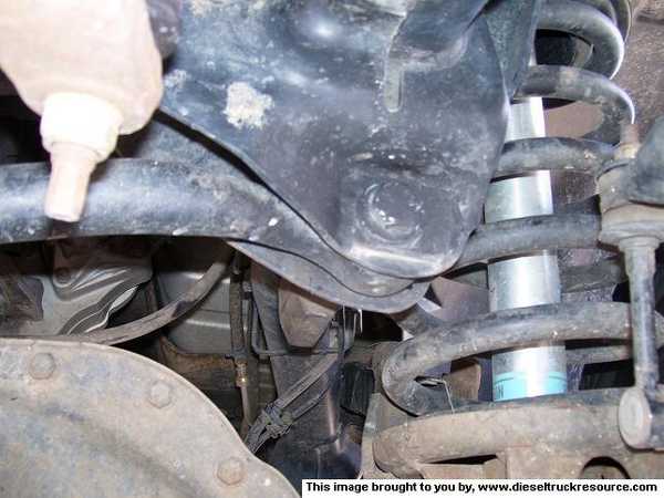

i built some sway bar drop brackets and rear bump stop brackets out of 2in square tubing.

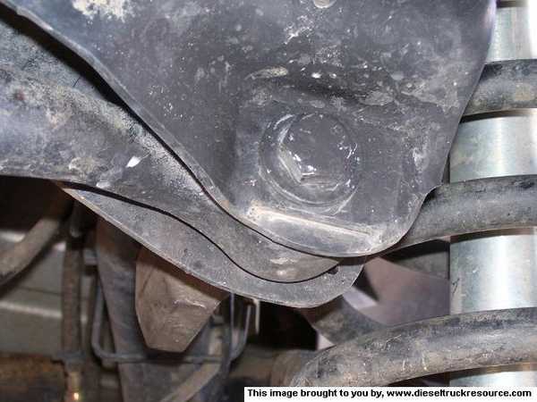

i also relocated to hole in the frame for the track bar to center the axle. i drilled a new hole and reinforced the hole with 3/16 plate welded to front and back of the factory bracket. i drilled the hole about .400 over from stock location.
so far everything is working together pretty good. feel free to ask any questions.

Looks great Scott!
The new wheels/tires look great, perfect height too...

Man the truck looks sweet, I dont know much about suspension work but it looks like nice work.

thats a nice setup you got there

sharp truck

i was going to try and make a drop bracket but this ended up being easier. and its still at the same angle as the steering linkage that goes from the pitman arm.
