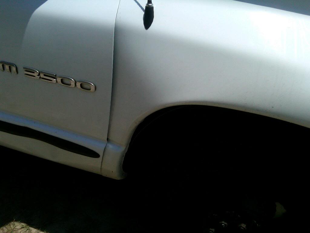

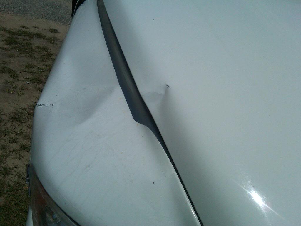

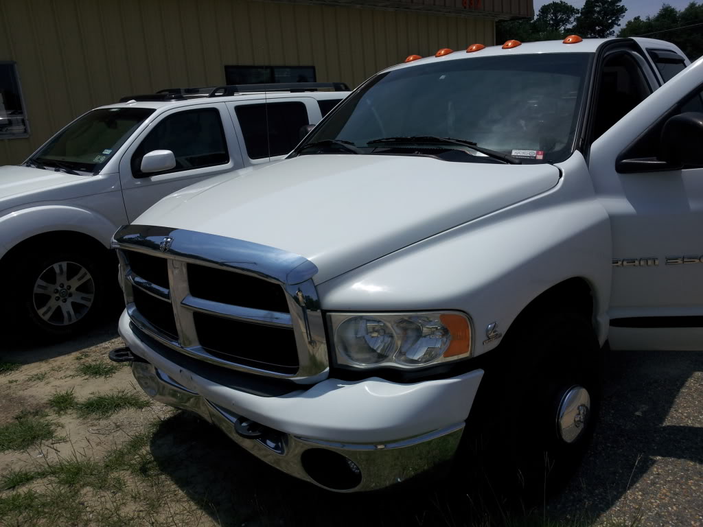

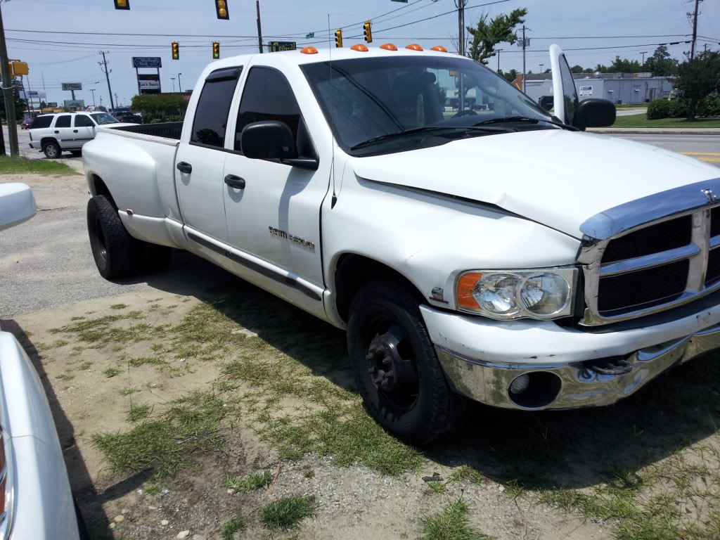

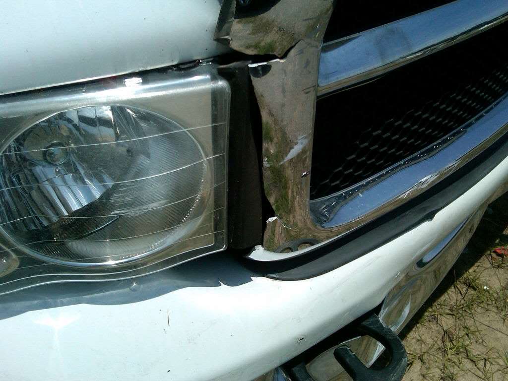

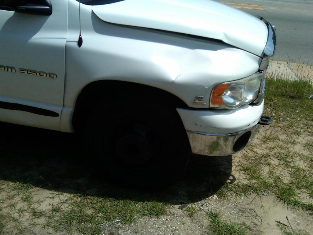

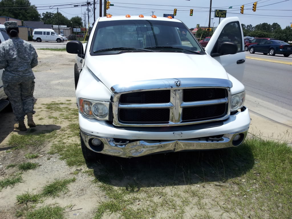

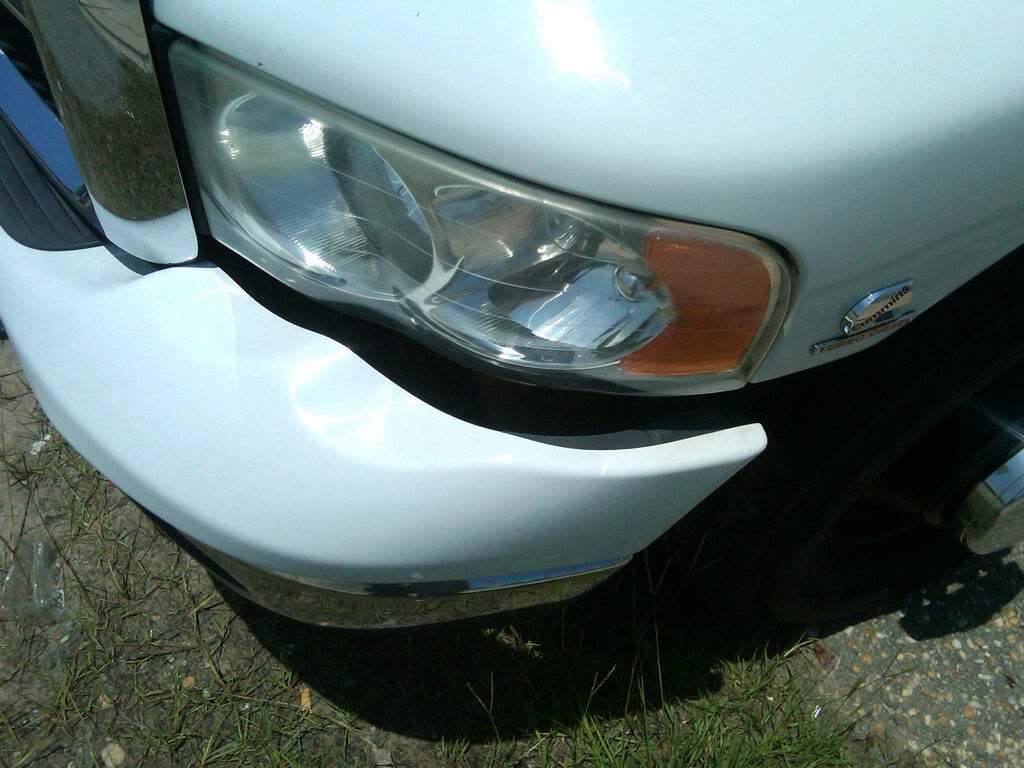

Here it is:

Well, it's not as bad as I was imagining. The obvious: fenders, hood, grill, headlights, bumper and core support. Things I would inspect closely would be the intercooler, condenser and radiator (front and back in case the fan came in contact with it).
Old Jun 19, 2012 | 12:20 AM
han solo's Avatar
Posts: 337
From: Alberta
Without being there, Im image the turbo is fine. But I would ask for the charge air cooler(intercooler) to be pressure tested for leaks. That would be my biggest concern under the hood. After that, engine rad, air conditioning condensor. Then frame, steering, suspension, etc. I should have read Jimbo486 post. He had all listed out. Sorry, my bad.
