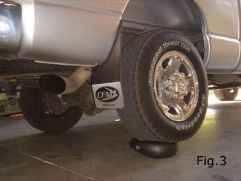

Originally Posted by Erik@TVP
****, that is odd for sure. Not sure any of the aftermarket intakes are forged, but even cast aluminum would never explode. We have run trucks at 60psi, even with twins without issue, so I suspect it was either defective or perhaps someone had stress cracked it by leaning on it or something. They definitely arent designed to be load bearing!
Would you consider this not load bearing? From their advertising. This really isnt to start a p@##$%g match. Just trying to caution people mainly. Our tech was lucky not to get hit by it.
Maybe that's the one they boxed up and sent to the dude who's truck you were running when it went BANG.

Oh no, not starting anything at all! That is truly concerning. They are (or should be) plenty strong, many OEM manufacturers including BMW have been using thermoplastic for years and they are darned near indestructible. I have no doubt they would hold a truck, thats why I suspect something was defective or damaged on the one that blew.
