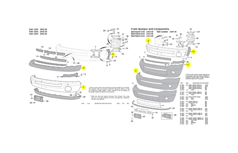

If anyone can review this to help me out, I have isolated the parts that seem to be required to make this conversion. From experience, does anyone know any different? SLT on the left. Laramie and Sport on the right. Parts on the left that are on the SLT and new parts on the right.

I put the srt10 front bumper on my 05 with no problem. Just one less bolt gets used. I don't know if sport bumper and srt10 are the same though.

I actually rear-ended somebody and the replacement is about equal. About $500 for the larger parts...Under-bumper, cover and supports. Not gonna put a new air deflector.

I just did this on my '06 Mega. You can re-use the left and right brackets on your truck which I assume has tow hooks. The pieces you need are the Laramie bumper beam support, the fascia itself and the chrome center piece and air dam.
