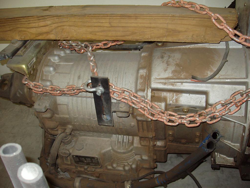

Here is a photo of the big ole' thing.
Attached Thumbnails Big Allison behind 1SC Cummins, anyone ever put in a Dodge truck?-p1010117.jpg

Thanx TonyB, but I am not doing anything with it, it is just on the ground and I thought it was interesting.
