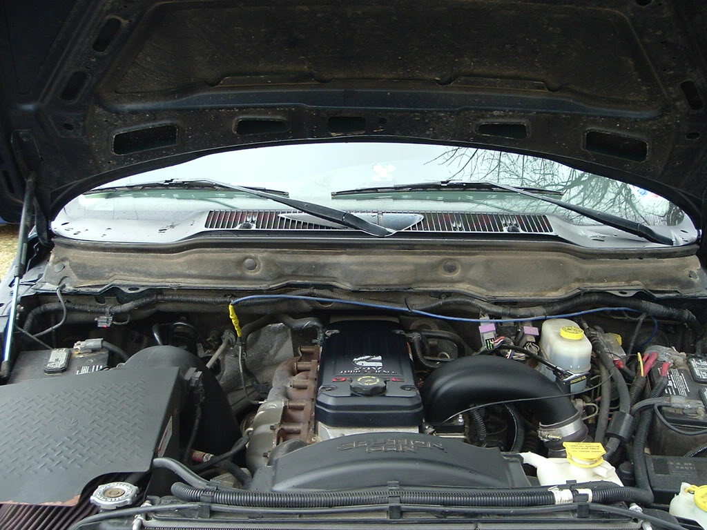

If you have a boost bolt then the pic below will orient you on where the line should connect. There is a black nylon tube in front of the intake horn. If you look on your truck in that area you will see the intake manifold (its a flat cast piece that the horn connects direct to.) One of those manifold bolts can be removed and replaced with the boost bolt.
Look HERE!
