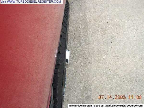

I originally had them on my red 03. They stopped the 315's from ballooning out so much compared to the stock rims.

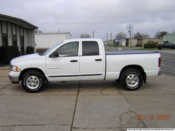

I also threw a pic of them on my 05 2wd. I really like them. The only thing is, these were one of the first sets off the assembly line and there are some tool marks on the indentions. The polished aluminum has held up well to my neglect. I just wish I would have held up for chrome!
