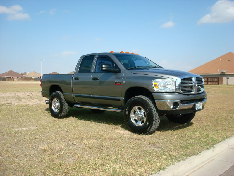

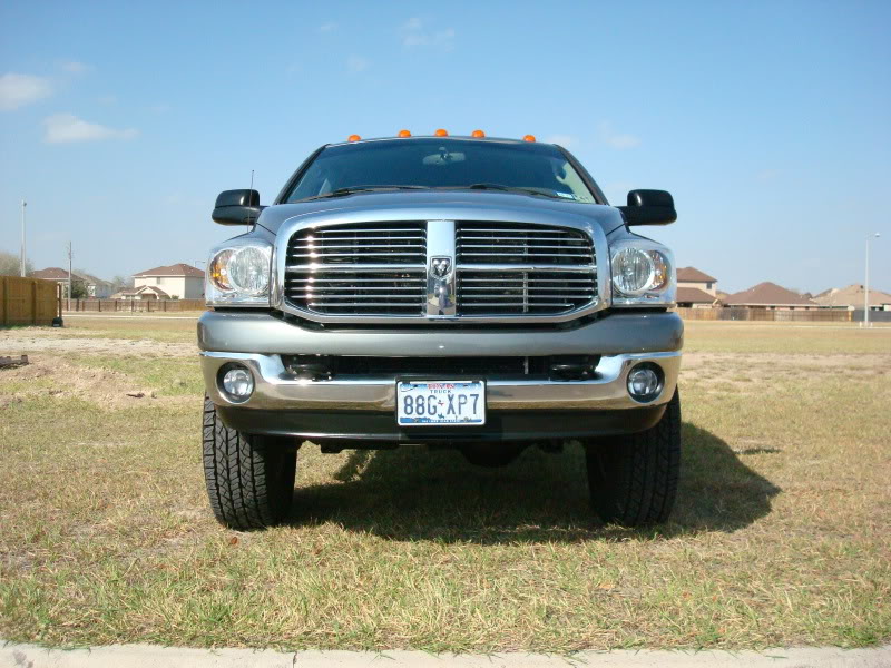

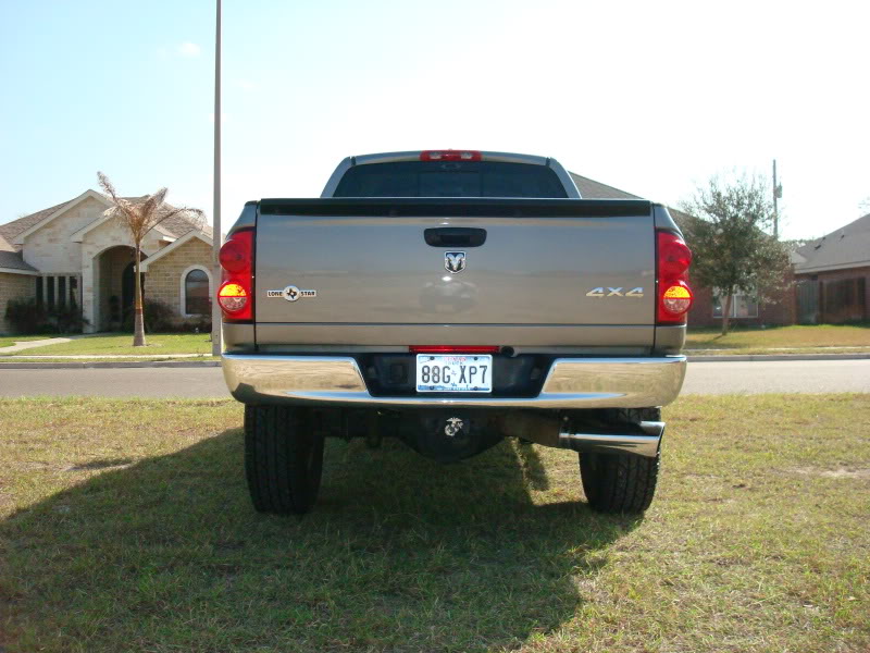

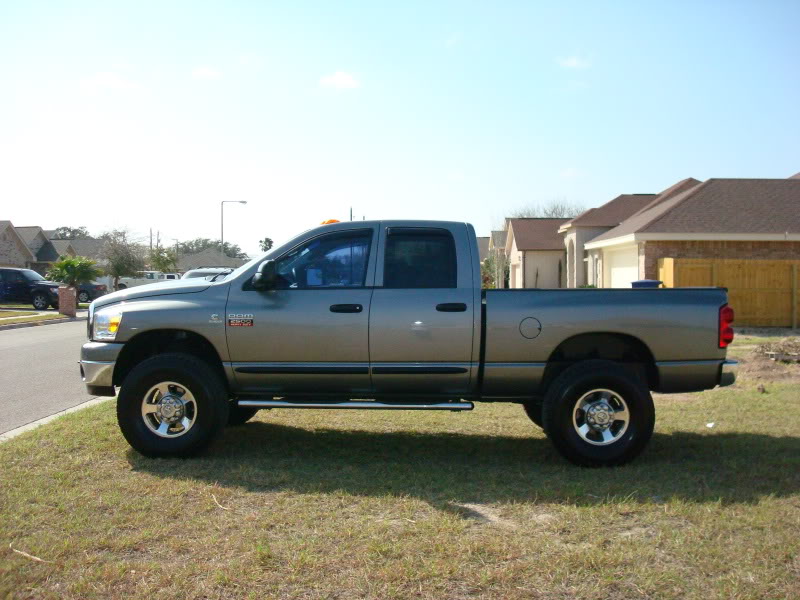

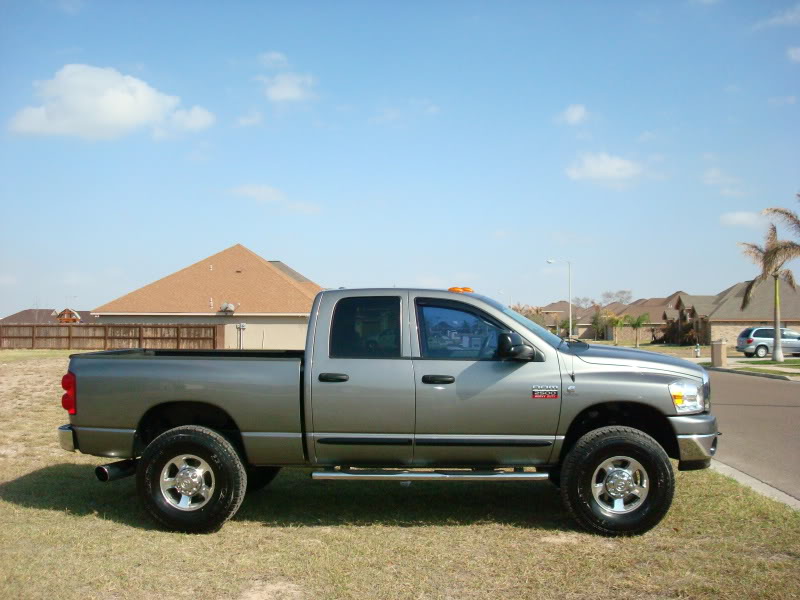

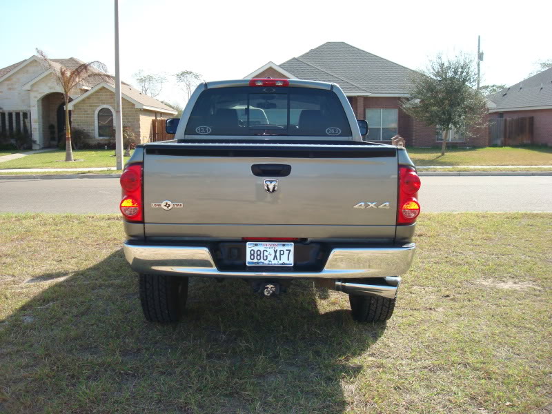

Post a pic please. I'm currently trying to decide between 35's and 37's on my '07. Not sure 37's will fit. Any rub? Do you have mud flaps?
Old Feb 20, 2011 | 06:33 PM
sidesteppers's Avatar
Posts: 2
From: Grandview,TN
I am running 315/70/17(Firestone Destination MT), awesome tire!!, on the Hummer wheels with 3:42 gears. Yes they do rub at full turn. They also will drop fuel mileage. I have not lifted my truck at this time. If you can stand the rubbing, go for it, they look great!
Old Feb 20, 2011 | 07:02 PM
Festus's Avatar
Joined: Jul 2003
Posts: 2,069
Thanks BroncoHound for the pics. I don't think 37's and my mud flaps will place nice together.
