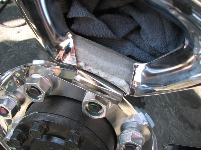

This is what I did:
Hope this helps a bit.
Scott.

That looks GREAT ! What did you use to get the remaining glue off, and what kind of paint did you use? My 07.5 has the same wheels and I would love to do that to them.

I used a wire cup wheel on a drill to get the silicone off, then scuffed the wheels with fairly coarse sandpaper, then red scotchbrite.
I used duplicolor wheel paint - flat black, two coats. It is holding up really well, but I don't drive on too many gravel roads, or go offroading.
Scott.

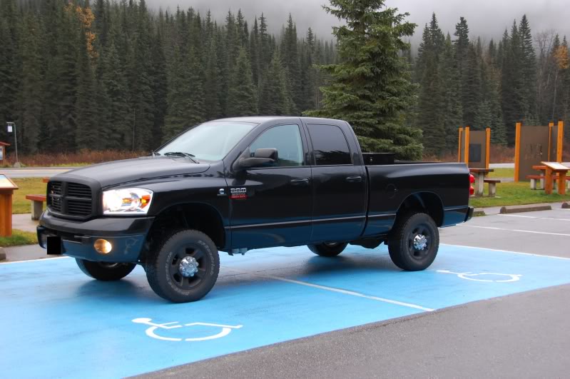

This is what they look like installed. They are actually flat black, not grey looking, like in the earlier picture.
Scott.

Verrrrry nice !!!
