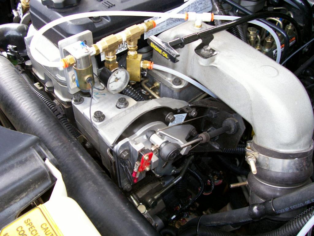

I use a momentary microswitch on my linkage under the hood as the final switch in the circuit.
One switch to turn the system on and off on the dash and the other relies on the throttle being at idle to allow the solenoid to energize.
