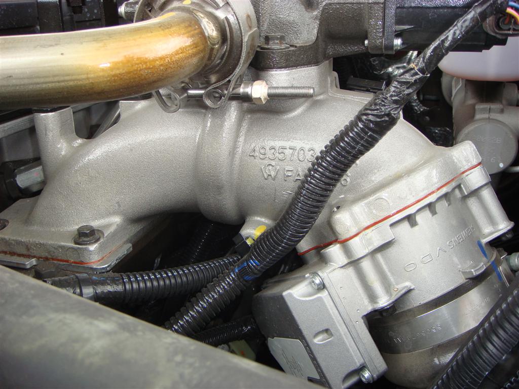

http://img122.imageshack.us/my.php?image=step9lk5.jpg
That should be a link to a pic of the butterfly

That butterfly door is a PITA. First is getting the assembly off. The gasket was either glued on or stuck to the varnish. Had to go back with a little RTV to makeup for the slightly torn gasket.
Next was the door itself. Applied heat via a blow torch to the screws and still broke off both screws. Ended up drilling both screws out.
The H&S kit went on without a hitch other than some busted knuckles. Truck runs great, sounds good and a drop of 200-300 degrees with the EGTs. Have a CEL (believe it's for the EGR), will have to live with that unless my Dad want to drop the coins for the Edge Attitude.
