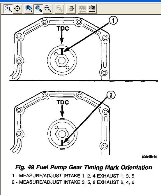

Once you set the dampener to 12:00 and verify that #1 cyl rockers are loose then adjust the valves in this order.
Intake on cylinders 1-2-4 and exhaust on 1-3-5.
Spin the dampener 360# clockwise back to 12:00 then adjust,
Intake 3-5-6 and exhaust 2-4-6.

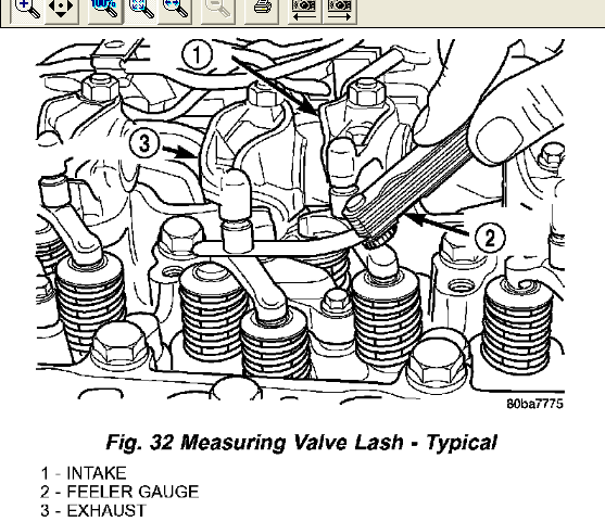

I believe the tolerance you want on the intakes are .010 and on the exhaust .020 on your 05. I set them so that I have friction on the feeler gauge. Reset torque on the jam nut to 18 ft#.
You can go in the firing order if you want too but there is no need for it.
The entire job takes around 1-1.5 hours, if its your first time it will be a little longer. Do yourself a favor and get feeler gauges with a 45* bend in them, it makes it a LOT easier.

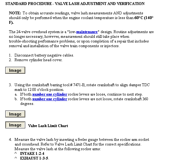

Old Apr 25, 2011 | 07:50 PM
goran_volvo's Avatar
Joined: Nov 2008
Posts: 39
This may help

Old Apr 28, 2011 | 06:22 PM
6spd05Dually's Avatar
Joined: May 2009
Posts: 236
From: San Antonio, TX
Originally Posted by goran_volvo
This may help
Thanks Goran! I decided to pull the rocker arms and pushrods and inspect them since I use the truck for long haul. That diagram and info will also be a big help. I appreciate your time. Holler if you guys ever need anything.
