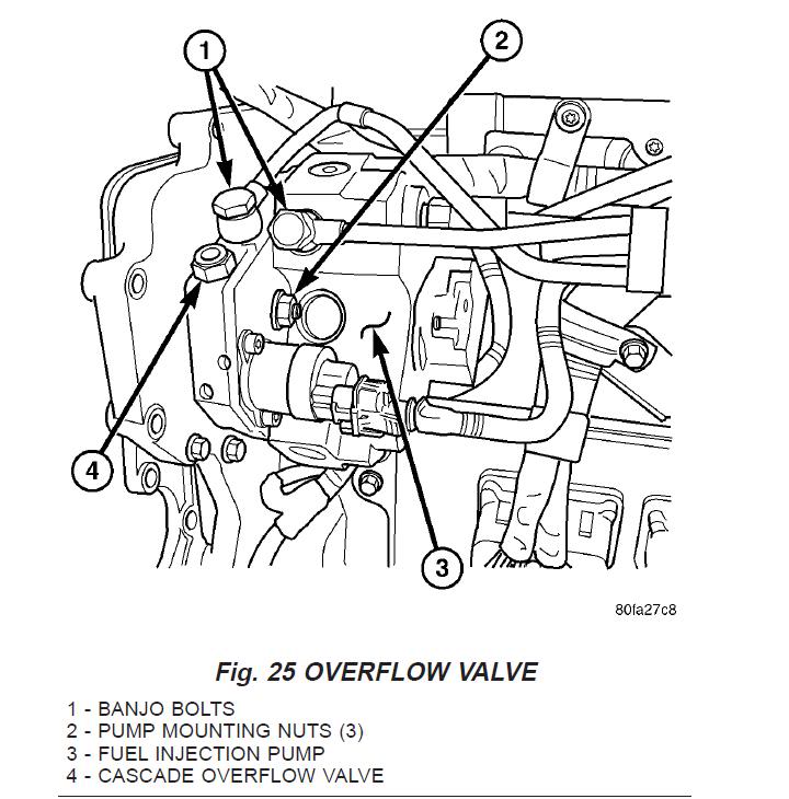

What is the Cascade valve for? I dont know if i should get the Arson 2 or the arson 3?

Go with the 3. You have the mods to use it.
