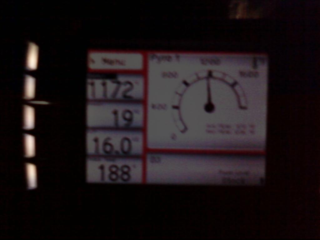

If my tranny hit 275*, I would freak the F out! SLOW DOWN and shift gears.
This pic of my gauges is climbing up Eisenhower pass I-70 west of Denver pulling 9500lbs , 2nd gear, 35mph... The other thought is NOT to add any power. I can't control my EGT's unless it is set on stock, which is where I always keep it.
