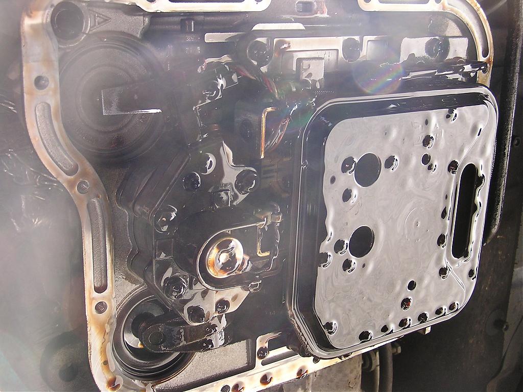

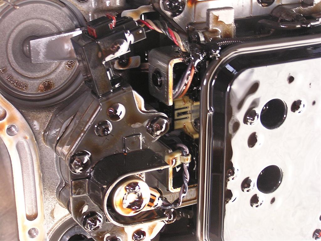

Ok, I took a picture after I opened it up. Dodge dealer says the Gov. Pressure Transducer. & the temp. sensor are 2 differant items. In this picture.... where would it be?
Thanks!

Right picture, top, slightly left of center, immediately right of the lever that pushes on the round servo......

Is it the wires that are twisted almost on top of the valve, looks like a red plastic lock on the conector or the multi wire that are not twisted in that picture. looks like 2 switchs.
Thanks,
Jeff
