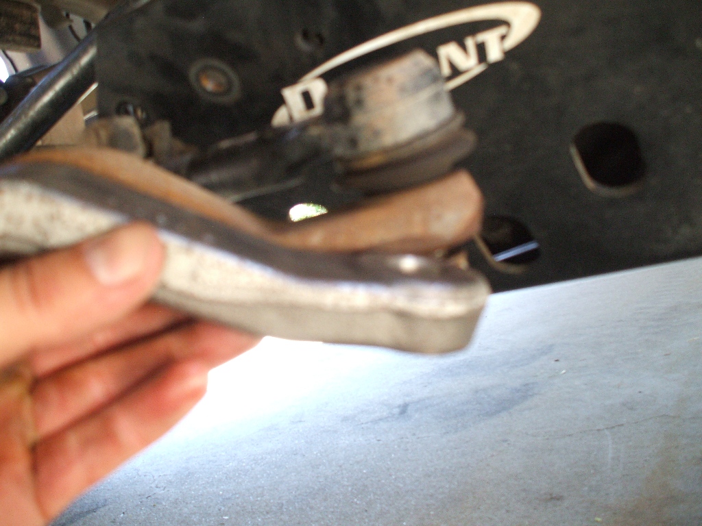

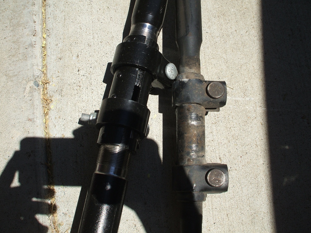

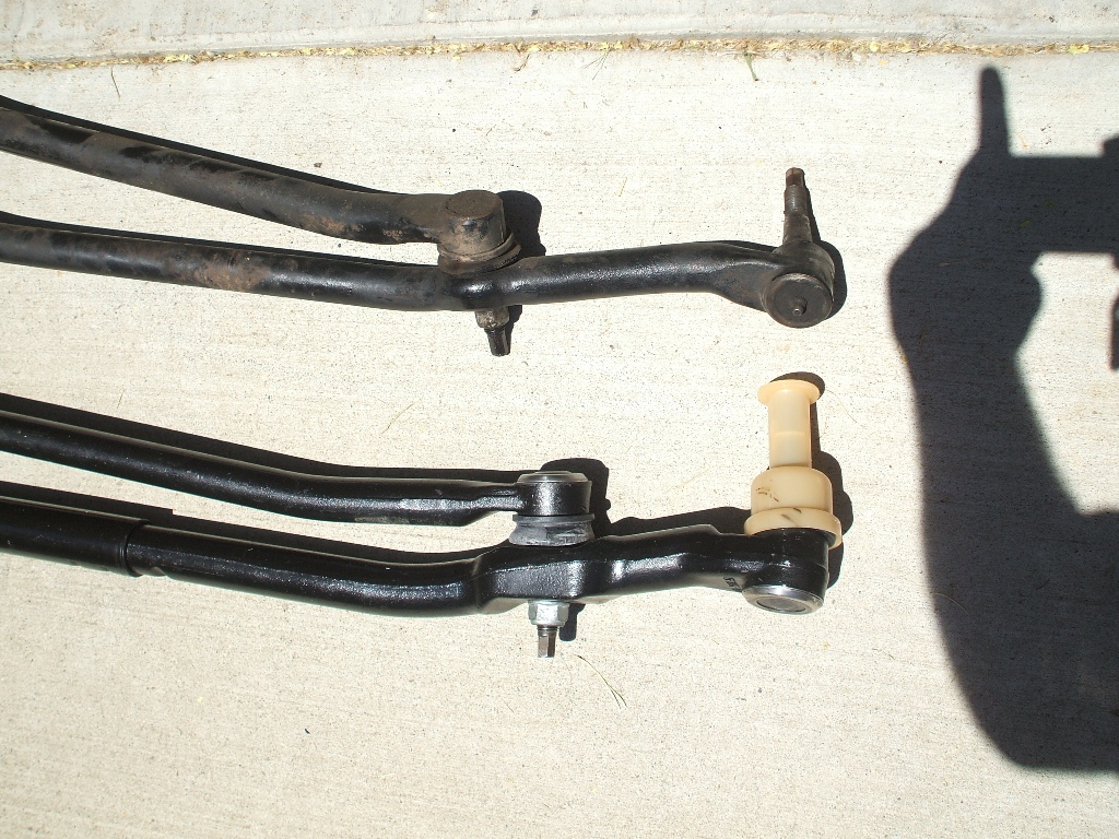

pics added for those who look
The "retrofit" that should be a recall is a boat load beefier than the original. I put it all in and did a rough alignment today hope i dont go through a set of new tires on way to Les Schwab tomorrow.

more pics
more pics.
...hope it works

Attached Thumbnails New update tie rod, drag link, and pitman arm going on tmro-dscf1687small.jpg   New update tie rod, drag link, and pitman arm going on tmro-dscf1688small.jpg

Have you got it in yet? How is it doing? Looks quite a bit beefier!

edd,
Glad you made the leap from the "rubber band" linkage world! Now look into track bar bushings and adjusting the steering box. You'll be fine.
If you want an example, come on down to Denair and drive mine. Better than new and over 200,000 miles.
