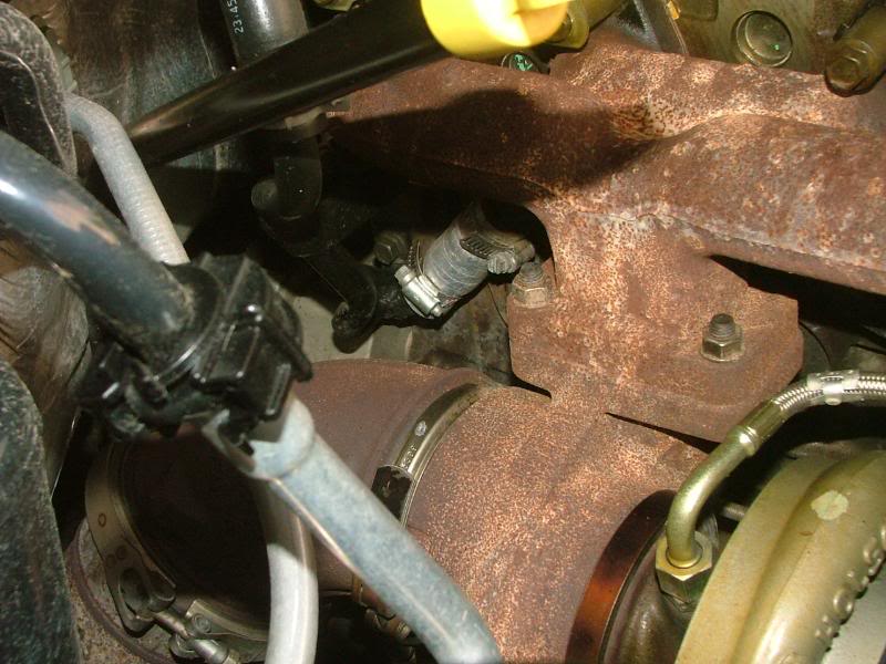

Some of the problems;

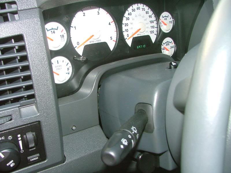

3.gear selector does not show it go into 1st (the tranny is in 1st though) the square just goes away and then it does not always show it go into park (again square just goes away), Not a clue. Could be the linkage needing an adjustment?

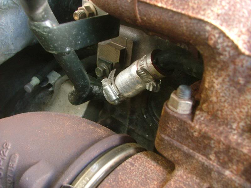

4.there is a orange rubber/silicone hose for the cooling system located above the turbo that leaks, Not sure of an orange hose on my truck above the turbo. can you get a pic?

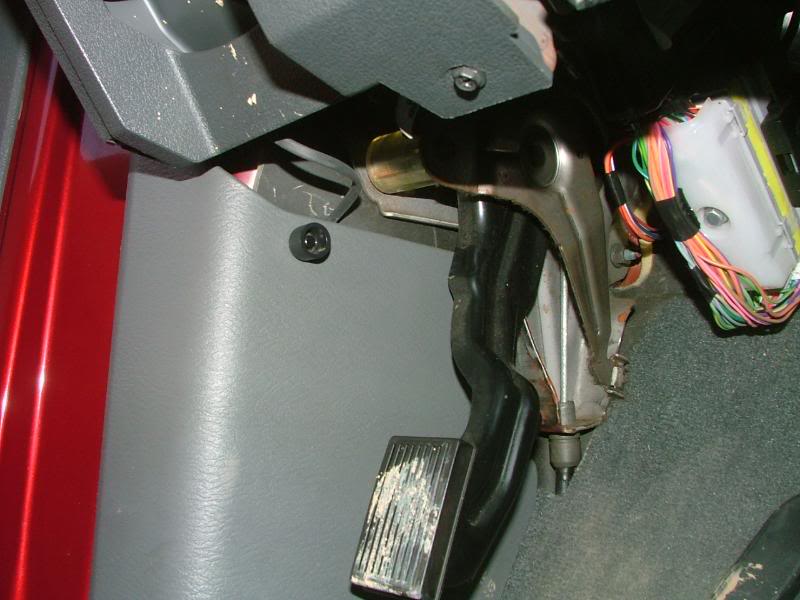

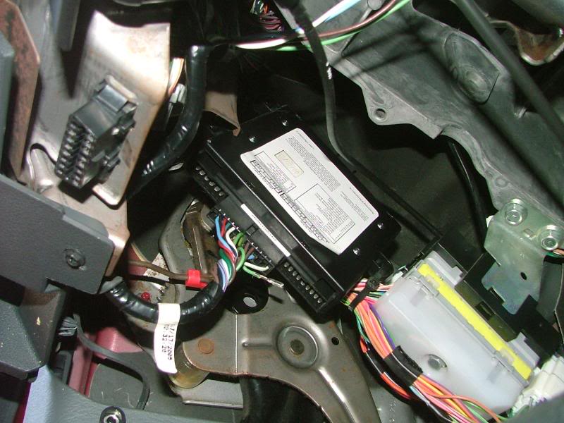

6.there is a small button on the driver side column near the emergency/parking break that I cannot figure out, Not a clue. Its not stock

4. Easy fix, dealer should fix.

6. Post a picture.

#4: Does anyone else have this, if not what does yours look like?
#6: I believe this is for the security system since it goes to that wire loom, but I do not know what it does

The hose over the turbo is a common leak area. There is a new/improved hose and clamps for that spot. That said many people just tighten it and it is fine.
The button and LED are not stock so it could be anything but you are most likely correct that it is part of an aftermarket security system. It could also be the problem with your shift indicator. If you have no manual or instructions for the add on then I would suggest you try to remove it from the truck otherwise it will just be a source of gremlins that will drive you nuts.

I'll take a look at the tube there on my truck and see what clamps are on there. I haven't found mine leaks.
