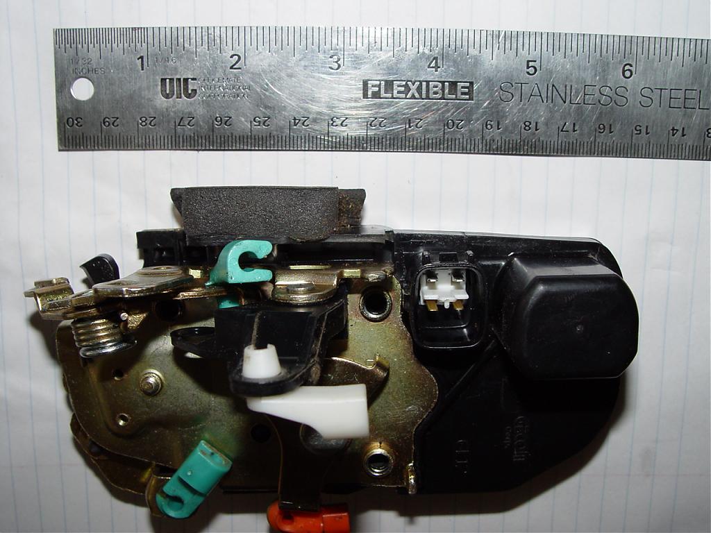

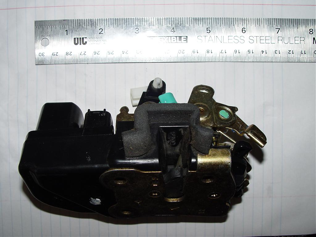

DieselAvenger: I had the same thing happen to me late last year. I was sure someone had tried to break into my truck but that turned out not to be the case. Turned out to be a problem with the latch assembly (may not be actual name but you get the idea.) Your symptoms sound exactly as mine did so I suspect you will need to change this part out. Pics attached.

Changing out the latch assembly is a little more difficult because there is not much room to work inside the door. There are three (star headed) screws holding it to the door. There are rods that go from your manual lock, door latch etc. that feed into the latch assembly. These are color coded which you can see in the pics. You will just need to remember which rod goes to which color. I believe there is only one wiring harness that plugs into the latch assembly.
