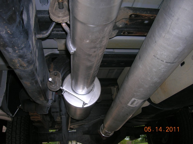

It solved all my vibes, and won't rust, looks "purty" too.
Attached Thumbnails Big Aluminum Drive Shaft...Another Success Story!-dscn0280.jpg
