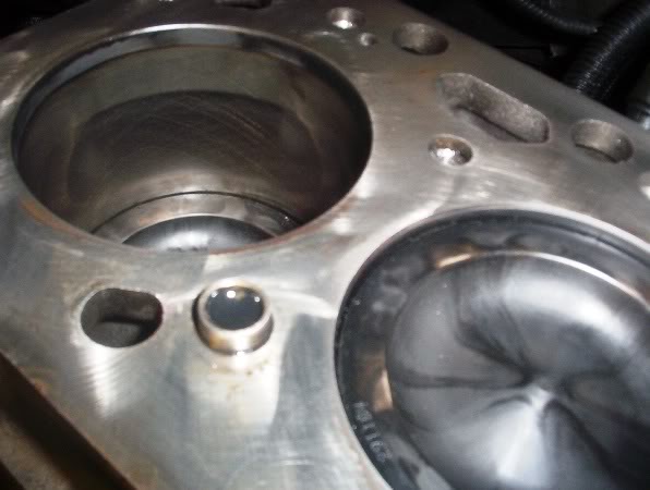

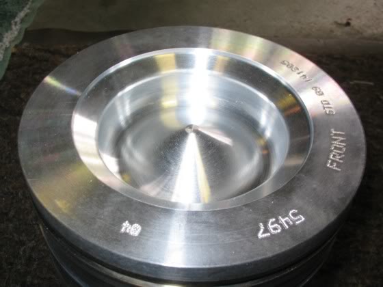

Old Sep 28, 2009 | 10:58 AM
homewrecker's Avatar
Posts: 1,628
From: N.C.
This is an 03-04
04.5-07

The pistons you melted are from an 03-04 engine. Sometime is May of 04.5 is when the engines got onto the streets with the 3 injection events and the newer piston design.
The 235, 250 and 305 HP engines have the older style like you melted.
The 325 HP engines use the newer style

yeah mine was made in jan 04 and is the 325 and they are the same as the second pic
