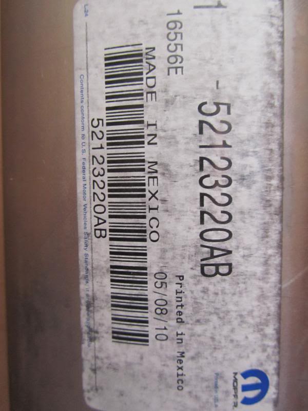

This guy's got the right one. That's the number I used and ordered from www.dodgeparts.com. It was under $500 including shipping and it had to come from WA state to southeastern PA. You two have the same truck and my QC LB is the same whellbase so I'd say it should work for you...
Originally Posted by Ra'am
Just replaced the two piece with a one piece on my 06', Megacab, 4x4, auto. The part# for the auto is 52123220-AB. List price was $602, got it from MOPAR4LESS for $430 plus shipping. Next best and easiest mod on my truck since the Smarty Jr.!

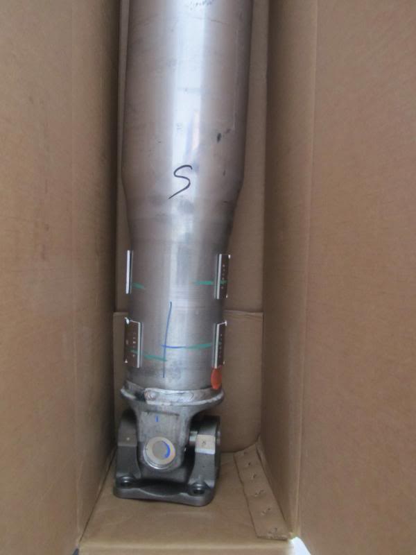

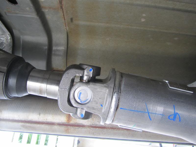

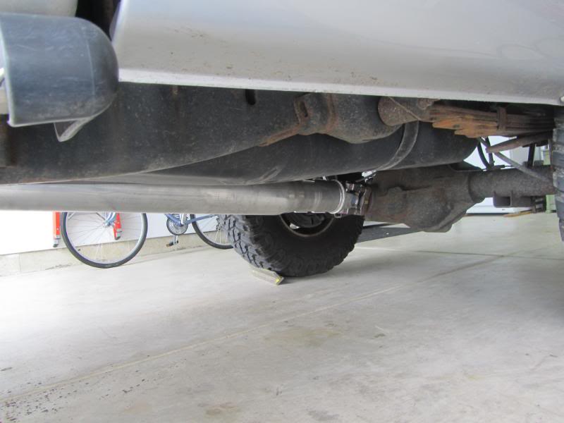

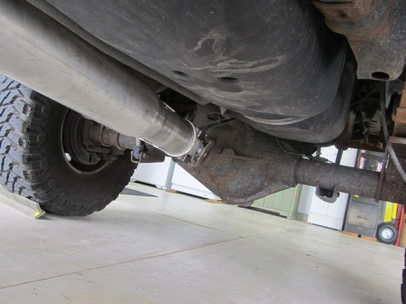

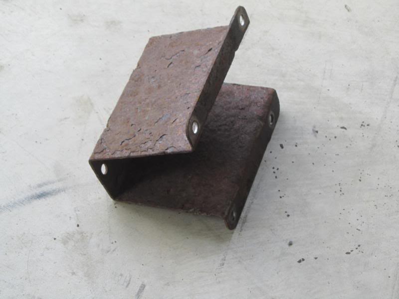

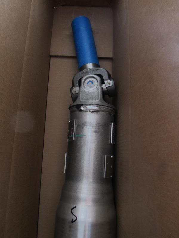

I ordered mine from Rich at Dog House Diesel about 4:00 PM on a Tuesday and it was at my house by 12:30 PM on a Thursday......this thing is oh so beautiful!
Install took less than one hour.....
I removed the four bolts securing the shaft at the axle end and placed a jack stand under the stock shaft
I then removed the two bolt for the carrier bearing and placed the shaft on another jackstand
I then slide the front of the shaft out of the tcase and used a hard rubber mallet to smack the flange, at the axle end (rusted)
I then removed the four bolts for the carrier bearing mounting bracket and slid the new shaft in place
I cannot believe how frigin heavy the stock shaft is, compared to the Mopar aluminum shaft
With my small lift, there were not any issues with the front stub shaft and the splines
Enjoy the pics:

The trucks accelerates very smooth, day and night difference
