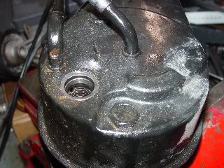

Sinking feeling... that photo looks NOTHING like either the pump that came out of it first, nor the one that NAPA sent home with me (different than the one replaced with Carquest part).
There is mention in instruction sheet of needing to take out assembly in the port you are showing IF lines are not compatible.... but the FSM warns against taking it out! says you won't get it back together again once it explodes or some such thing.
NAPA part looks like the Cardone, third one down on this link
http://www.partsgeek.com/catalog/199...ring_pump.html
The one that came out and the carquest part look like the top two on that page....
Obviously I am not getting this done today.
Halfpint, the pump is imbedded into the reservoir. Your original pump had two bolts holding the assy together. Rebuild pumps from most auto parts stores do not come with the bolts, they have the plastic plugs you found. When the pump was changed the installer needed to remove the bolts from the old pump and install them in the new pump.
My original pump lasted over 400k. I replaced it with a lifetime warranty rebuild...........4 times in less than 100k. I finally bought a new OEM from Mopar4Less and couldn't be more satisfied. A new one will come complete, including the cap. The Saginaw pumps we use have been around for over 40 years and are installed in a lot of different applications (my '67 Chev C20 has one) so there is no telling what internals are inside the rebuilds. If you love replacing pumps over and over, stick with the crappy rebuilds, or you could spend a few dollars more and get one that is dependable and made for your truck.
One extra note. More than likely the rebuilds will have some red ATF in them when you take them out of the box. Our systems use power steering fluid, ATF is a no-no.

That's all good info. Thanks very much. Are those bolts that thread through the reservoir housing and into the pump casting some special shoulder bolt to seal, or ??
I will have to call Mopar4less tomorrow, their website is plumb useless. Hopefully they still carry these parts! Our local Dodge dealer in Monroe is a world class ripoff outfit, I will not deal with them, and the gummint just shut down BBC Dodge in Burien (who were the best).
I knew that the pump type that I found on the truck when we started all this mess was just like those on my early Chryslers and Imperials back in the 60s, a very familiar shape. I am a bit conflicted on the "power steering fluid" thing, though. Red-Head stated that ATF of the newer type would run great in this system, especially as we were starting with a "dry" system. What in particular is different in the 8 bucks a quart Mopar part number stuff the dealer has vs the $4.50 a quart for the ATF-4?

The bolts have o-rings and the heads are larger than the heads of most bolts with that size shank. Saginaw sells a rebuild kit that includes the o-rings if you don't have them. About $8 at O'Reillys.
IDK what year Dodge started using ATF in the power steering (3rd gens maybe) but my owners manual has a caution in it about using ATF. I can only surmise that internal seals are not compatable. You don't have to use Mopar PS fluid. If you used ATF I recommend you flush the system completely. The turkey baster method requires you to draw all the fluid out of the reservoir and fill with new, then start the engine turn the wheel lock to lock, shut it off and repeat about 6 or 7 iterations.
