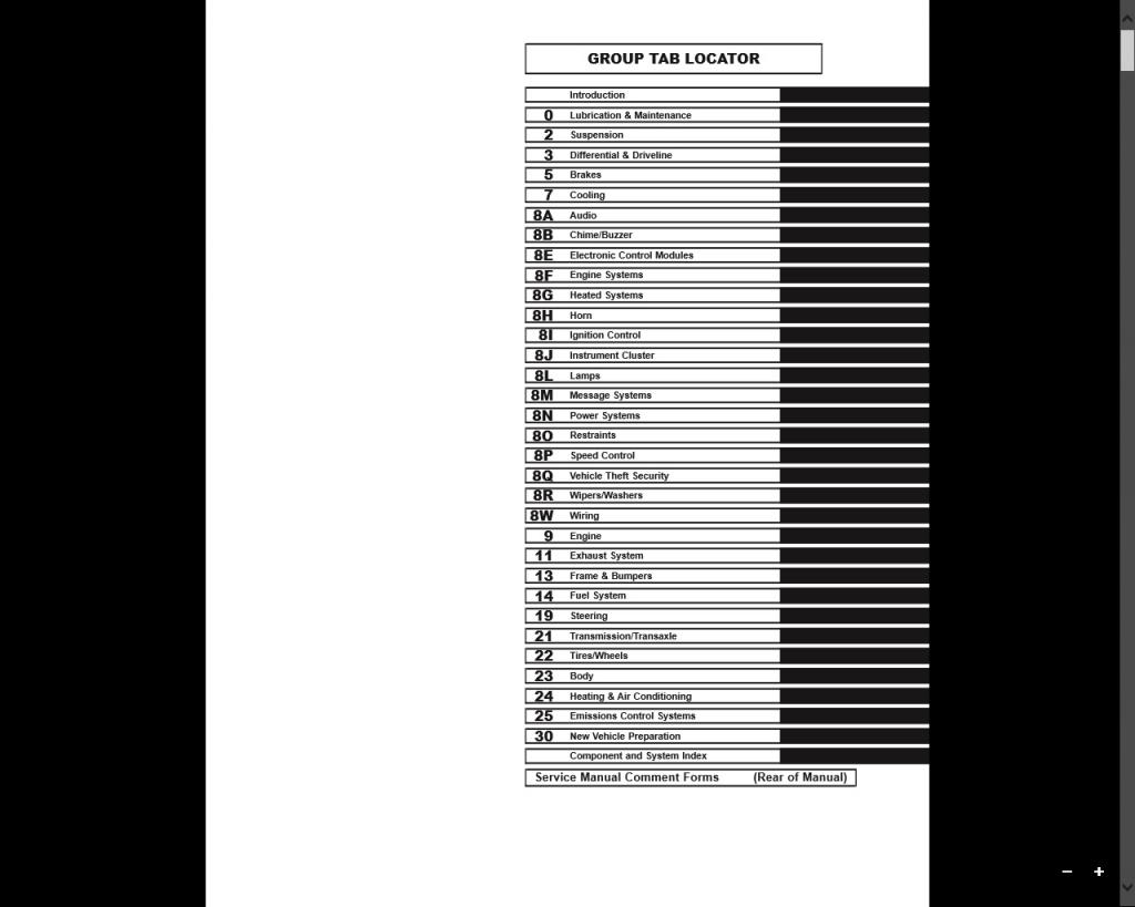

Does your manual resemble these first and last pages of mine patdaly"
Attached Thumbnails Needing trouble shooting steps for cruise contro-dodge-manual-first-page.jpg   Needing trouble shooting steps for cruise contro-dodge-manual-last-page.jpg

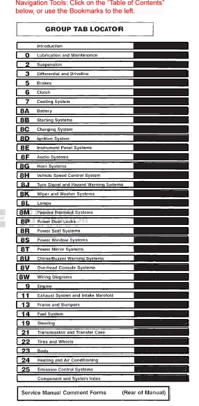

Very similar
I think part of it is the manuals we buy are put out by Mopar Restoration Parts, not DC.
Here are first and last page, the major difference is yours shows DC and mine shows Chrysler Corp.
If you want, on your 2001 section we could compare an individual page to see what the specific differences might be.......

Old Jul 31, 2014 | 05:35 PM
Humblecowboy's Avatar
Joined: Aug 2009
Posts: 174
From: Votaw, Texas

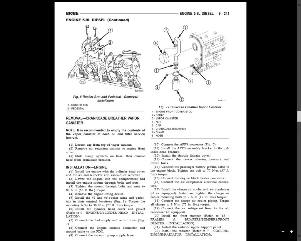

I'm posting the "Engine" sub contents and the sub sub contents of that. I'll post a couple of random pages from that also.
Attached Thumbnails Needing trouble shooting steps for cruise contro-dodge-engine-sub-contents-2-page.jpg   Needing trouble shooting steps for cruise contro-dodge-engine-5_9l-sub-cont-2-page.jpg

OK, I'm giving the "Puke tube" page the honors here since that is one topic covered pretty often.
Attached Thumbnails Needing trouble shooting steps for cruise contro-dodge-manual-puke-tube-page.jpg
