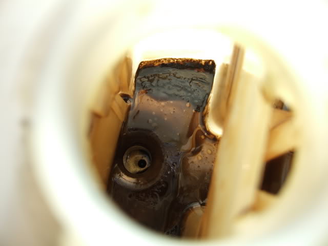

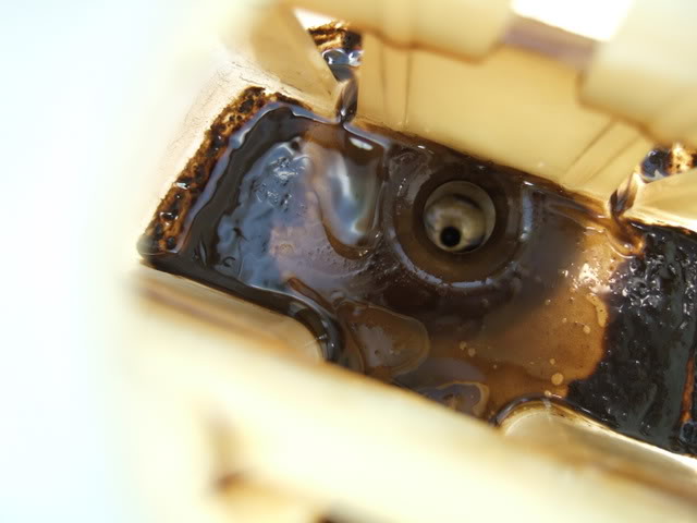

Here's a few pics of the bottom of my reservoir, it's not a pretty sight.
Replaced the brake master cylinder and all seems normal.
The brake fluid was dirty as heck and the bottom of the reservoir had a some brown silt and possibly drops of H2O.
Bled a 32oz bottle of brake fluid through the system until clear fluid flowed out.
I think this problem was occurring on and off for the last month or so because I would smell burning brakes once and a while,
look around for the idiot that left their parking brake engaged. I guess it was me!
I guess it does pay to flush you brake system.
I believe the secondary piston in the brake master cylinder wasn't moving freely caused by the contaminated brake fluid.
