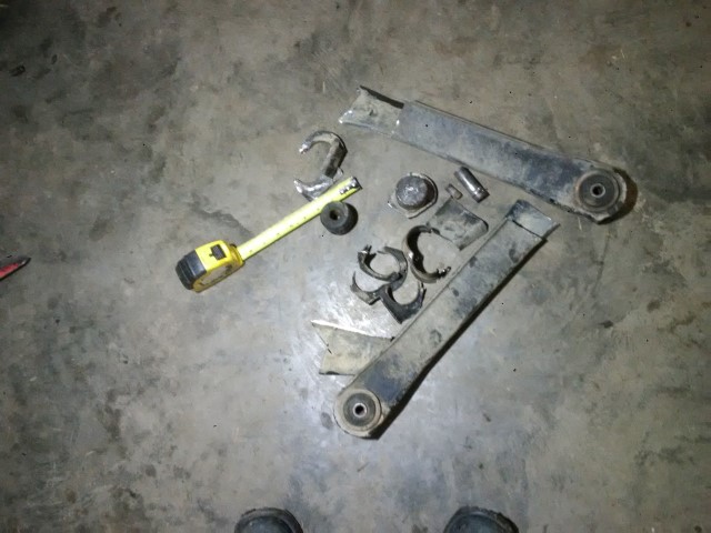

I thought the pic said it all.
When the bolt is rusted solid to the inner sleeve of the bushing, you've got limited options.
Pressing and beating wasn't getting anywhere. It was bending and fatiguing the brackets.
Teeth were burning off sawzall blades due to the hardness of the bolt. Zip disc didn't have the reach to slice the bolt. We had the cut the majority of the arm off, and then destructively work away at the remaining metal with the zip disc, layer by layer, beating and prying the fragments apart, peeling out the rubber, and finally dicing up the bolt and sleeve till they fell out.
This is the third 2ndgen truck I've disassembled arms on. At least one bushing bolt has been seized on each truck - this last one it was both uppers on the frame end.
Copious amounts of thread-lube, never seize, etc, needs to used here for serviceability....much like the unit bearings in the knuckles.
