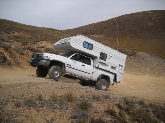

With the camper on, driving @ 62 mph, I get 15 mpg on the flat. (10,000 lbs. gross) Not on the flat:
