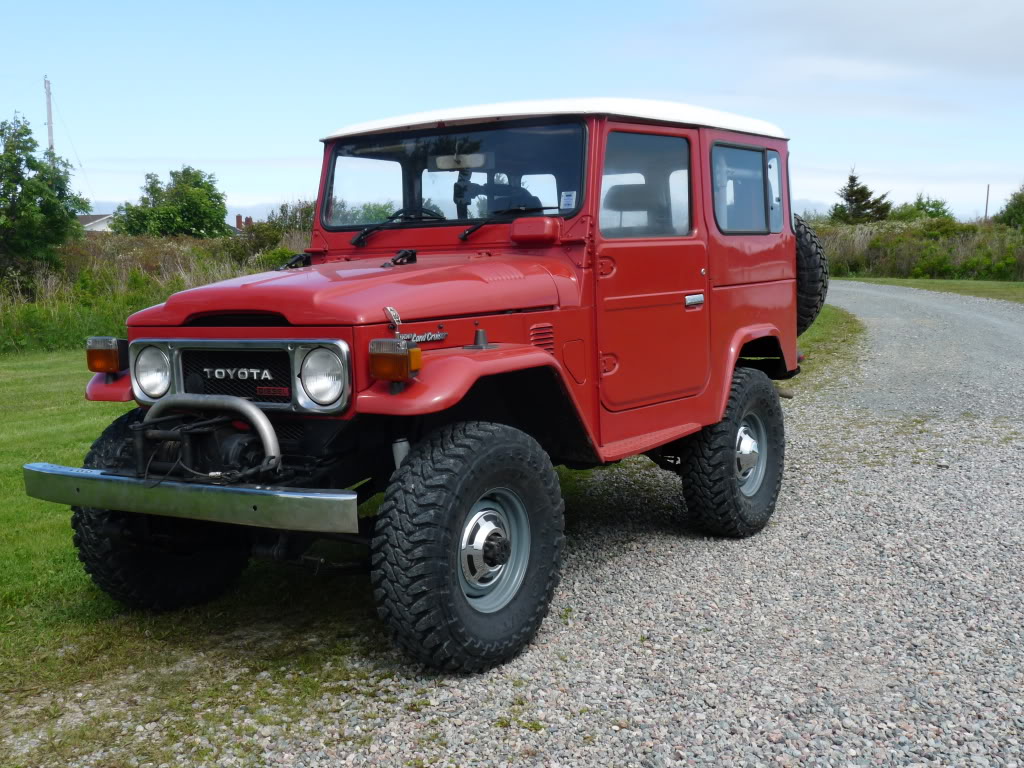

I find they rust bad just after the master cylinder before they reach the frame. Still don't know why they rust so bad there. I have to replace mine there on the 97 and 98. Mack attack it seems we have the same tastes you need to get a 98 and an 02 to catch up though . We got the same BJ and 3500 , my BJ is RHD though , love that 3B eh...
