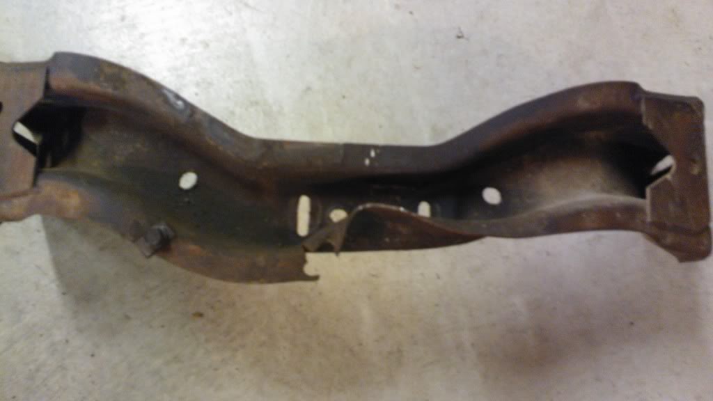

Anyway's Check out this bent cross member! I had to use a pipe wrench and a 4' cheater to bend it back enough to get to the bolts as it was fully peeled back over itself.... wonder if this is the creek and pop I here when in parking lots?
What in the world did you hit? As for the trans lines, I talk them of at the trans. Make sure you have a wrench on both nuts so you're not turning the one in the trans. If you have a lot of grease zip tie a rag over the line. Once the lines are disconnected from the trans they should move enought so you dont have to disconnect them from the cooler on the motor.

Yup I have that bent cross member and the drivers side of the truck sits a inch lower than the passanger side... the previous owner said that the previous owner was wasted, blew a turn and landed in a river, drove up the river (in late august) in shallow water to a boat ramp and got out- then drove home. This explains the bent cross member, and wasted tie rod ends, and front berrings, borken dana 70 axle, bondo under crappy paint and the cheap $2k price of the truck

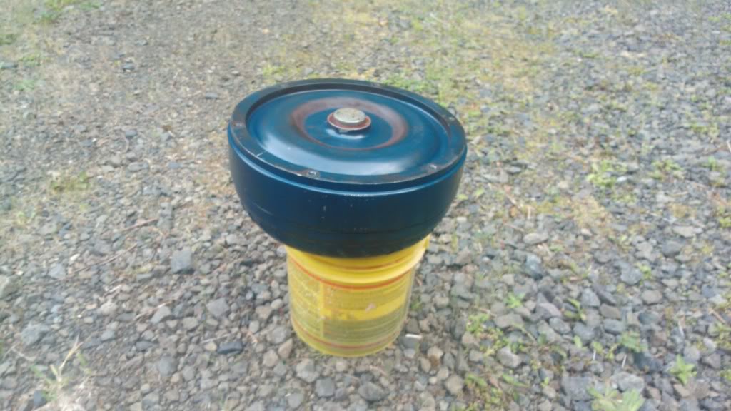

been working on the trans for a hour or so after work each day, the worst is all the linkage and junk on the drivers side! SO here is the old Torque converter, does it look stock? I also only found 4 quarts in the pan and only 3 in this converter- where is the rest of the oil hidden at?

The cross memeber though, wow even with a bottle jack and 4x4 its not even close, im putting it in from the back of the truck, as the taper allows but the cross member is still a good 1" wider than the frame
Im wondering if its sprung from that tear as seen in the above pict
