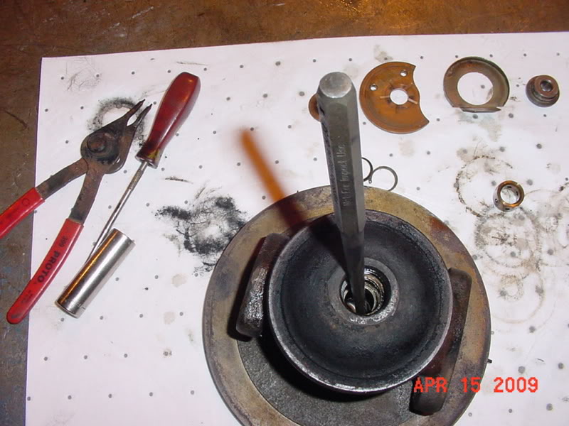

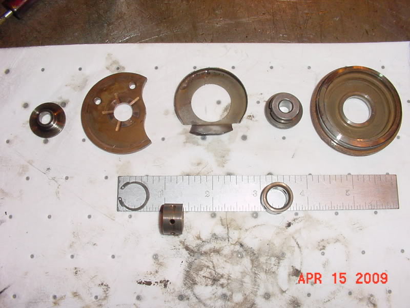

scottsjeeprolet Mar 31, 2010 05:24 PM
2 Attachment(s)
I've got a HX35 torn apart right now. Waiting to get the rebuild kit to put it back together. They are very simple inside. I thought they had seals but there are none.
Attachment 68891
Attachment 68892

Where are you getting your kit from? is it a holset kit or aftermarket?
