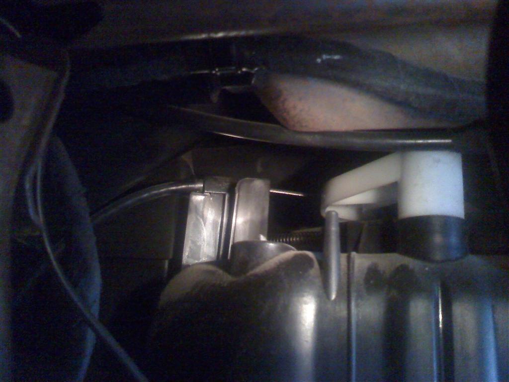

blend door for a 98.5 is cable operated..Unless, like the fuel tank module, they used more then 1 type that year

Biododge1 I think you hit the nail on the head.
I moved the dial and could feel the electronic lever moving. I was pressing my finger on the motor shaft to see if it worked while I operated the lever. At one point I got good hot air then after I removed the pressure it slowly went cool again. I'll take it off and see what I can see. update after.
Thanks
