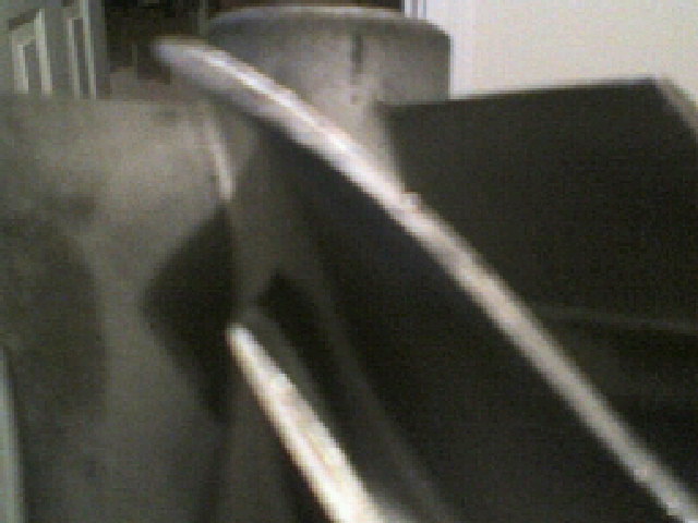

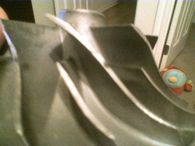

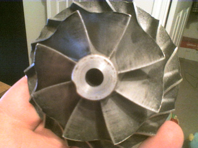

I believe they are just angled blades.....i'll get a pic of a spare compressor wheel i have laying around.
Old Dec 17, 2006 | 05:56 PM
TheBigNasty's Avatar
Posts: 1,048
From: Central "By God" Texas
All i had was my phone camera but you can still see. They are a hair deformed from contact with turbine housing , this is from the first time my turbo was shelled.
