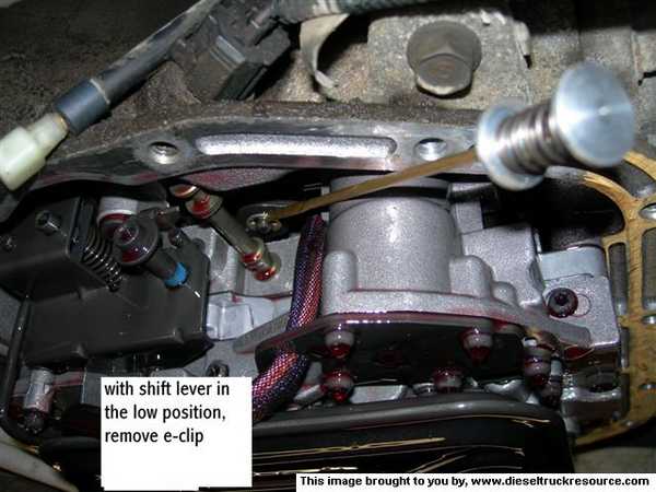

Thought this wasn't going to be too hard to do with some friends but we were all wrong, just spent about 3 hours trying to figure out how to get the valve body off to replace my TCC-O/D solenoid. We followed the instructions from http://www.xtremediesel.com/manuals/...stallation.pdf on page four it says to remove the park e clip or something like that, we could never find any clip to remove, we removed every bolt from the valve body so that the side towards the passenger side of the trucks will lower a little, BUT, we cannot figure out how to release the the shift cable from the valve body so the whole unit can lower out. can ANYONE help us? Pictures or any input would greatly be appreciated!!!

Did you remove the kick down lever and shift lever? The e-clip is on the parking rod.

j-fox is right. This is on the drivers side, the lever goes down through the case.
Here is a pic

K is the e clip that clip that the rod is pointing too? and you remove that? then the VB should come out? I removed the lever so that i can play with the gear selector and push it back and forth. Or is the e clip on top of that whole assembly with the gear selector?

That is the E-clip that's being held with the homemade tool. YES.
you have to pull that clip off to get the park rod out of the VB.
If all bolts are out and electrical plugs then that's it. Now remember the accumulator spring on the passenger side. It will fall if you don't hold it or clip it so it stays in the case.

Sorry to bother again, but the valve body that you have picture doesn't look like mine when comparing where that e-clip is. That one is pretty well viable, mine definitely isn't, I still can't figure out what to release to get the VB to fall, its caught up right where the shift lever goes down into the VB area.

Your Instruction sheet from BD/Xtreemdiesel is named 1030416_417ValveBodyInstallation[1[.pdf
http://www.xtremediesel.com/index.as...ROD&ProdID=544
This is for 1996 through 1998 47RE's
See steps #6 #7 #16 and #19
Follow your shift linkage back to the case. There is a electric plug (safety switch) right there too.
Look closely at the pic in the instructions, there is the front drive shaft boot in the pic to help you get orientation. Also the Band adjustment nut.

You have to take the kickdown and the shift lever off of the valve body. They are on the outside of the case. They use a pinch bolt to hold them on the shaft that comes out of the case. The kickdown is a 10mm I think and the shifter is a 7/16 . loosen them and you may have to pry them open a little with a screw driver and slide them up off of the shaft. Then it should come down enough to give you some access to the park rod e-clip. NOTE: I have taken the VB out with the park rod still attatched. It can be done, but taking the clip off makes for a much easier installation. You will need about 6 hands if you try putting it back in with the park rod still attatched.

Thank you guys so much, I just all of the levers off from the outside of the case.
