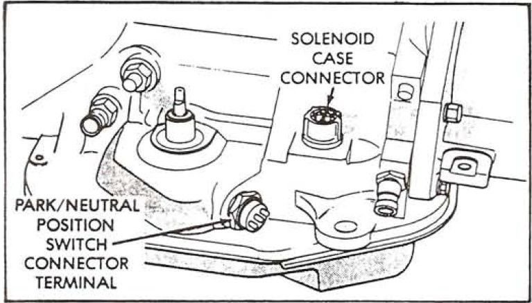

I took a look under the truck after work , all I could see was a two prong plug with 3 wires attached to it . I unplugged it and plugged it back in . As well as wiggled the PCM plugs around a bit . Couldn’t quite figure out how to unclip em and didn’t want to break the plug . I did notice also my two vacuum lines attached above the skid plate are pretty loose so I zip tied em on a little snugger .

You will need to look into the solenoid case connector. The Park-Neutral switch is there for the starter inhibit and for the reverse lights. The other connector goes to the PCM and carries the power supply for the sensors (governor pressure, temperature), their signals, and the solenoids (Governor Pressure, O/D and TC Lockup)
If left to it's own devices (unplugged) the 47RE will have a governor pressure that puts it in 2 if you select D, and the pressure will not rise with the vehicle speed because there is no power to the solenoid.
Also if the sensor does not supply a plausible value the PCM will effectively "unplug" the transmission.

Do not drop the pan at first, use the solenoid connector on the transmission to check the ohms of the solenoids. (If good you know it's the wiring outside the trans, if bad you need to drop the pan and go in there.)
